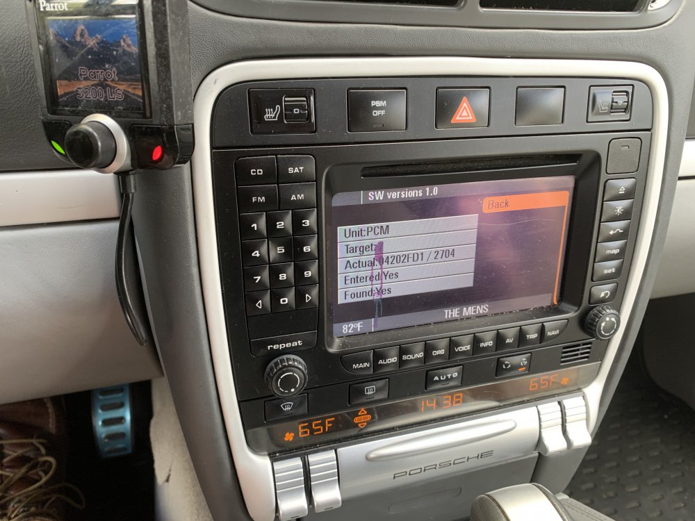

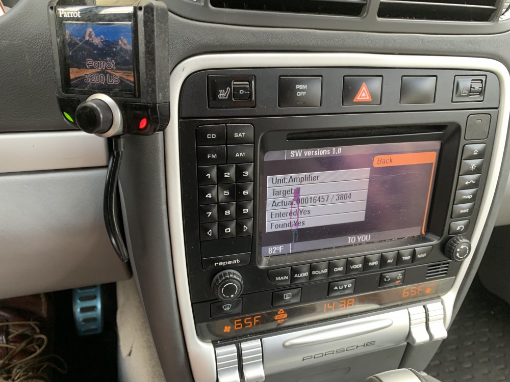

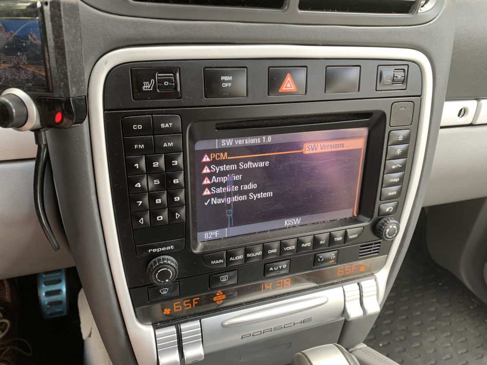

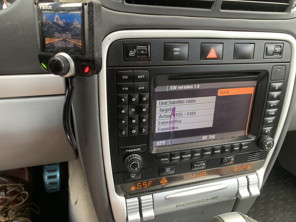

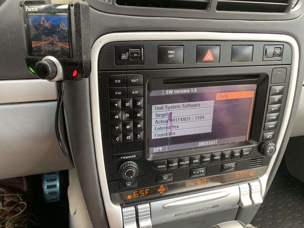

The radio seems to lack some functionality and definitely has some software issues.  I'll attach photos.

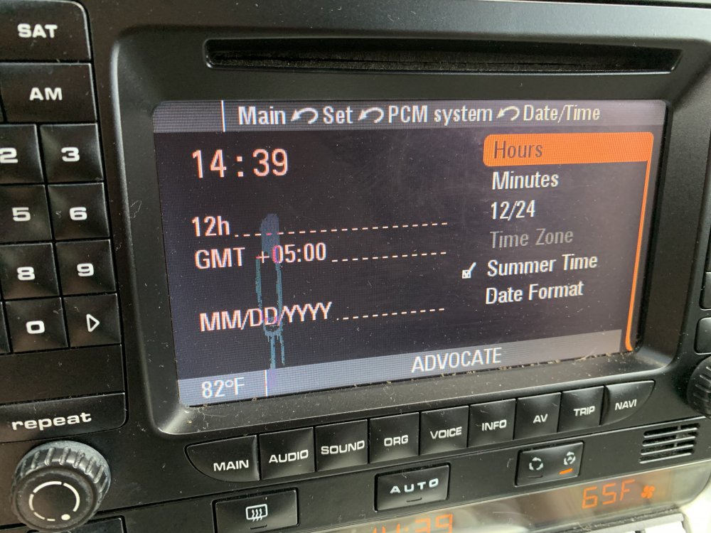

Don't mind the cracked screen/dead pixels.  CDs play fine, tuners all seem to work.   It will not let me set the date at all, or time zone..  Pretty sure it's a software issue.  I've even attempted the 1-4-8 reset, and watched it re-read each attached device and still gets errors.

Just curious if anyone had any input on the Radio Firmware issues?  I also can't set the date on the nav unit, I can't even get to the option.  I newly installed a MOST adapter so I can add Bluetooth/USB connectivity to the stock unit (loops into the fiber optics - hooked into the back of the head unit) Everything seems to function - audio wise - but I still get those triangle firmware issues.
The GPS positioning shows correctly on the maps, but the "current location" in the settings menu shows Anacortes WA when that's 60+ miles away from me.
