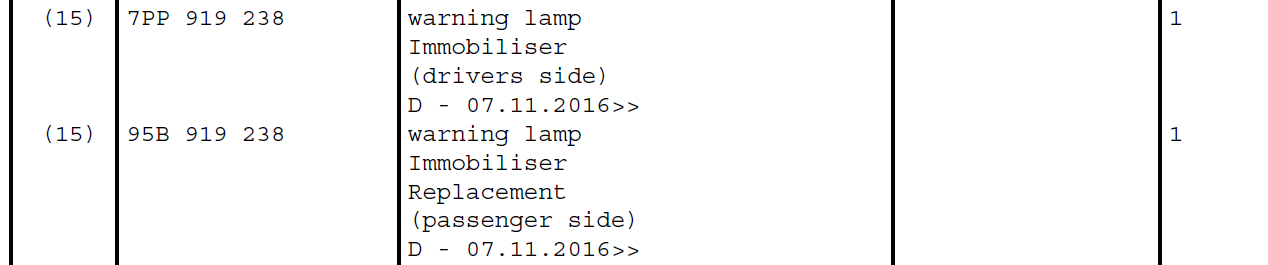

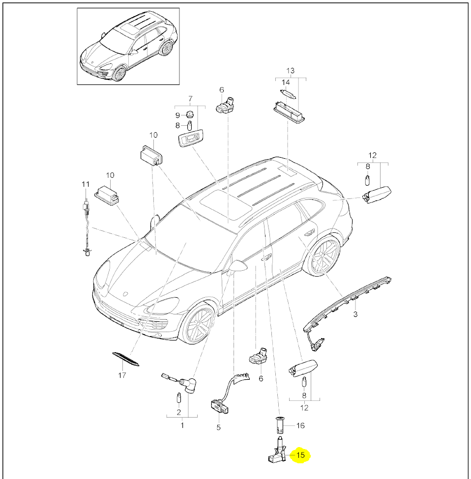

False - it can be ordered separately.  It looks like the part number is 7PP919238 (possibly with "A" or "B" at the end). Could you verify?
If so, they can be purchased for less then €10.
The other option is to replace the LED yourself, but I'm not sure of the level of your fine-motor skills or patience.. 😉
 image.thumb.png.6bebf4fa54d8f4f3a03d1562255c4c6d.pngimage.thumb.png.51058cf9981ae205b1be4e825b78e523.png
My faulty one is on the drivers side (UK).
Just been having a look through a US dealers (Atlanta) website and have just came across the very parts drawing you have posted. Mine is a `13 model so i dont know if the ones from 11/16 >> will fit , the one shown looks similar to the VW ones but not the same as the one shown on P85 of the parts drawings :
