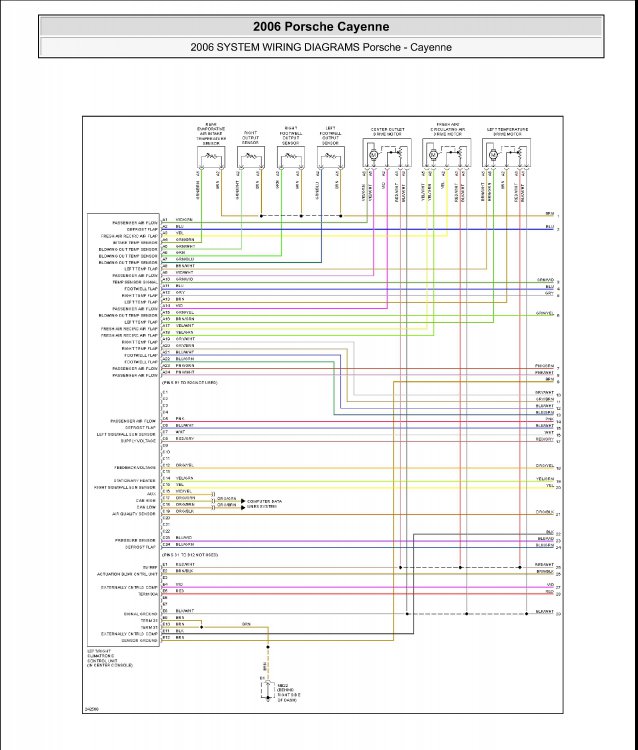

I just replaced the center vent in my '03 CTT and there are what are called "blowing out sensors" in the center vent.  I had already bought the part because the plastic dividers were broken, but before I replaced it, I started getting different temperature air from the left and right sides when the L/R temp settings were identical.  The problem resolved itself with the center vent replacement, so I assume it actually had a bad sensor.
The best piece of advice I can give for the overall "Cayenne Experience" is to buy a Porsche Service Manual online.  They're all over the internet anywhere from free to about $15 for the PDF download.  Best investment I made related to home repair and troubleshooting.  The attached wiring diagram is from the 'WIRING' section which is 100+ wiring diagrams.  The one I have is 60+ separate files totaling thousands of pages.
