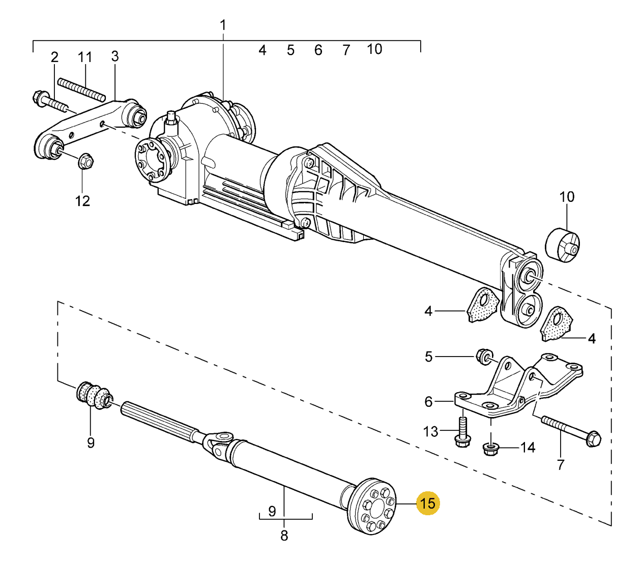

Talking to the tech he said that while cruising around 50-60 mph, trying to feather the throttle results in a clanking noise similar to when a dual-weight flywheel is replaced with a single-weight flywheel in a stick-shift car. Discussed everything from transmission mounts to a remap of the TCU, but couldn't come up with a solid theory. Other thoughts are potentially a front "donut" on the transmission being cracked or loose.

Front differential? Mine went around 83k. Not sure there is a tell take sign, maybe leaking fluid or a worn flex disc?

Didn't see any leaking fluid, but tech didn't want to take the car apart to diagnose a worn flex disc as it is a PPI. Will still keep poking around and see what I can get.
