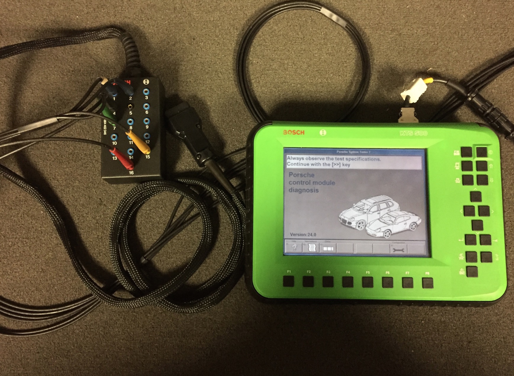

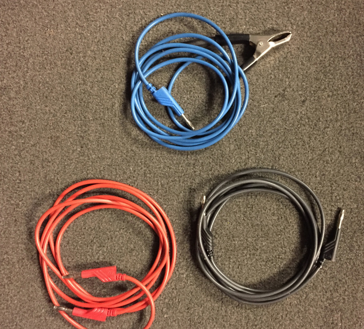

Just received a breakout box with some leads to complete my set of 996 vintage tool 😉 I've been using a PST2 since 2008 with a lot of success. Especially for friends that are looking to buy a use 996 turbo or simple troubleshooting and keys reprogramming.... But I never used a breakout box before and it is difficult to found information about how to use this tool especially on Porsche. Would like to test the internal voltmeter/ohmeter (URI) of the Bosch KTS500....OBDII pinout, 16 ports on the breakout box ? 6 leads, + ground (black) red and blue wires etc....Is there, somewhere, printed info that I can get? Pins assignment would be nice!!! Thanks for your help, J.P.

Finally, I was able to figure out the breakout box wiring and I did the test of the internal multimeter" Voltage work fine but I always got an error with the resistance function....Any clue?
I've receive an answer from a PST2 sellers and specialist on Ebay, Mike, and here's his answer about this error message with the PST2....
"That error is because the URI hardware module does not have the porsche special firmware; the firmware needs to be updated. I would not worry about it, since you're better off testing resistance with a hand-held multimeter. Some users burned out or damaged the motherboards when they tried to test continuity on live circuits, and unlike the PIWIS testers, the PST2 does not have fuse protection."
