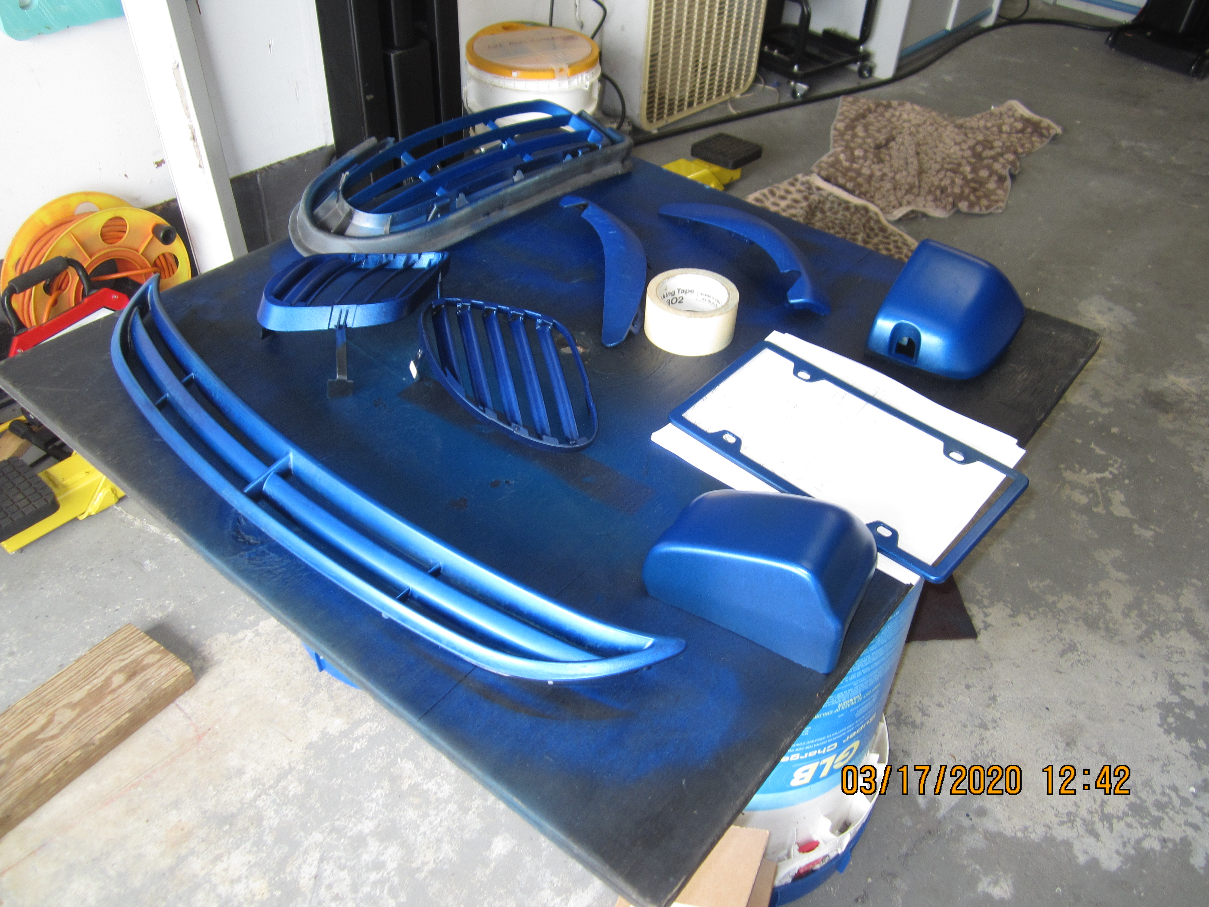

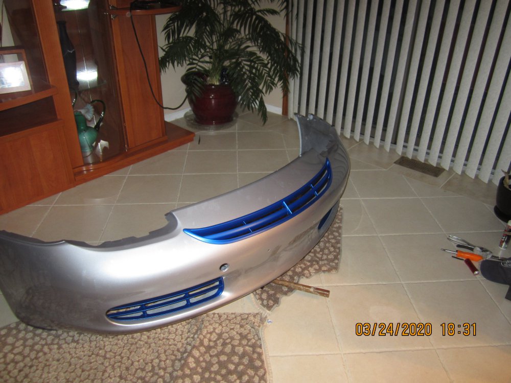

Thank JFP.  I just got off the phone with Pedro from Pedro"s Garage.He just told me to get the Maddox brand with many fittments from Harborfreight which has it for 79.99 and with 20% off and a $10 giftcard ,it's costing 54.The picture I'm sending is the new nose I did during pandemic and recovering from cancer.Hope you like it
