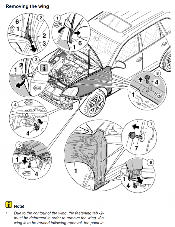

Hello ladies and gentlemen, had a bump and picked up a wing in the correct colour, having a go at replacing it myself. Almost there with taking the dented wing off. There’s a few awkward bolts around by the headlight and where the wheel arch meets the bumper - am I right in presuming the bumper needs to come off, looks like that’s the next step. But before I get stuck in could anyone confirm this is necessary? Also is their an affordable workshop manual to download anywhere?

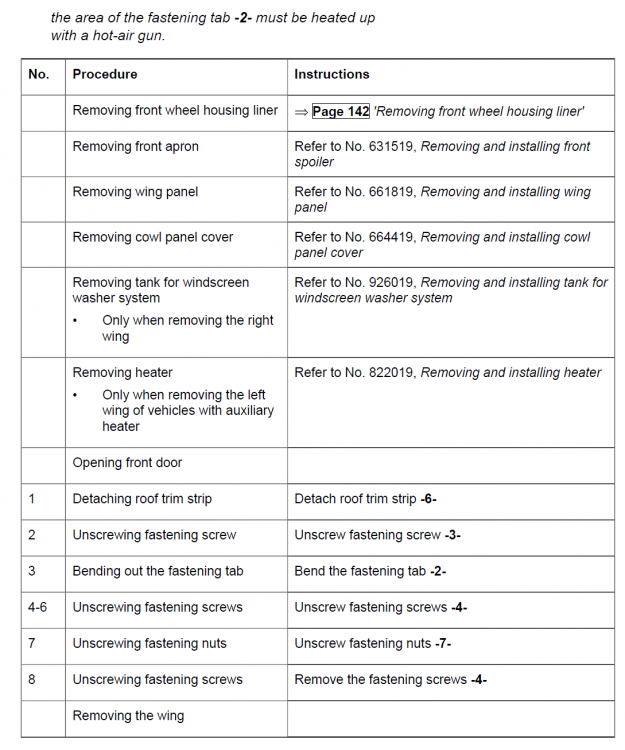

@Loren Hi Loren - and thank you! The further I got it became obvious, particularly around the wheel arch. I should have just looked closer at the new wing 😄
Your reply is really appreciated, especially including the guide from the workshop manual. It’ll be a huge help 🙌
