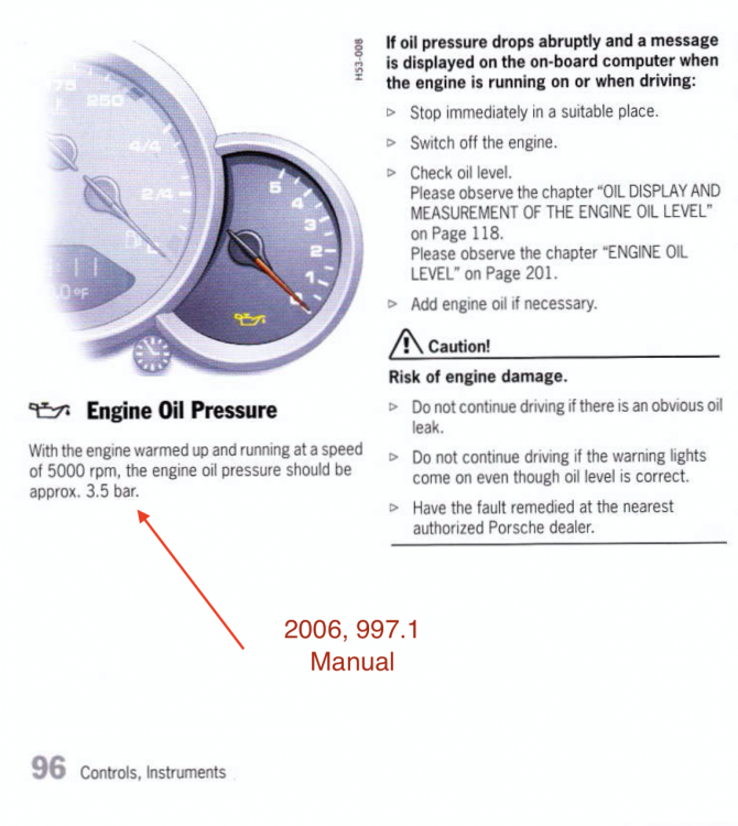

However, the next day I checked the oil again, again a cold engine, and the level was at the max mark.  I then warmed up the engine to operating temp, etc. and checked the oil pressure according to p. 96 in the manual which states pressure to be aprox 3.5 bar at 5,000 rpm.  Mine gets to 4 bar at about 3,000 rpm.
questions:
Is what the manual states ~ 3.5 bar at 5,000rpm an accurate indicator?  I mentioned it to the shop this am and they said don't worry.  If so, why is mine so different from what the book reads?

I wouldn't worry very much about the oil pressure, there are too many variables (oil weight, oil temperature, variations in the display itself, etc.) for it to be perfectly accurate; and in your case the pressure is higher than the manual, which is fine.

When picking up my car from the dealer the other day they gave me a print out of the testing for the oil pressure.  I thought it was interesting the difference between the owner's manual and what they gave me.  I cant imagine that it makes a difference in the readings as to whether the car is under load or at idle....  Anyhow, for comparison.  The shop did the Bar to psi conversions
Owners's Manual
Shop info
