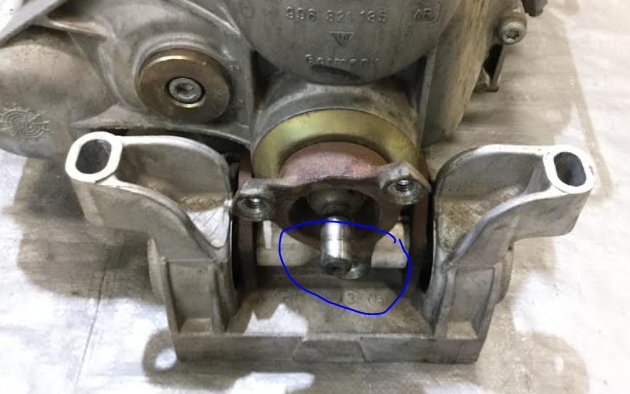

Hello - in attempting to replace the flex disc on the end of the cardan drive shaft, I found the drive shaft will not move from the front differential either way. I have put PB Blaster on it, but wondered if anyone has attempted, success, to get it loose to be able to move it forward.  Thanks for any suggestions!

It's not the Guibo that is the issue. The problem is the drive shaft will not move at the front differential and needs to move into the front differential to be able be able to clear the transmission piece that comes out near the Guibo per picture. I thought there may be a technique, aside from beating on it a bit (lol) to get it loose. Thanks JFP!
