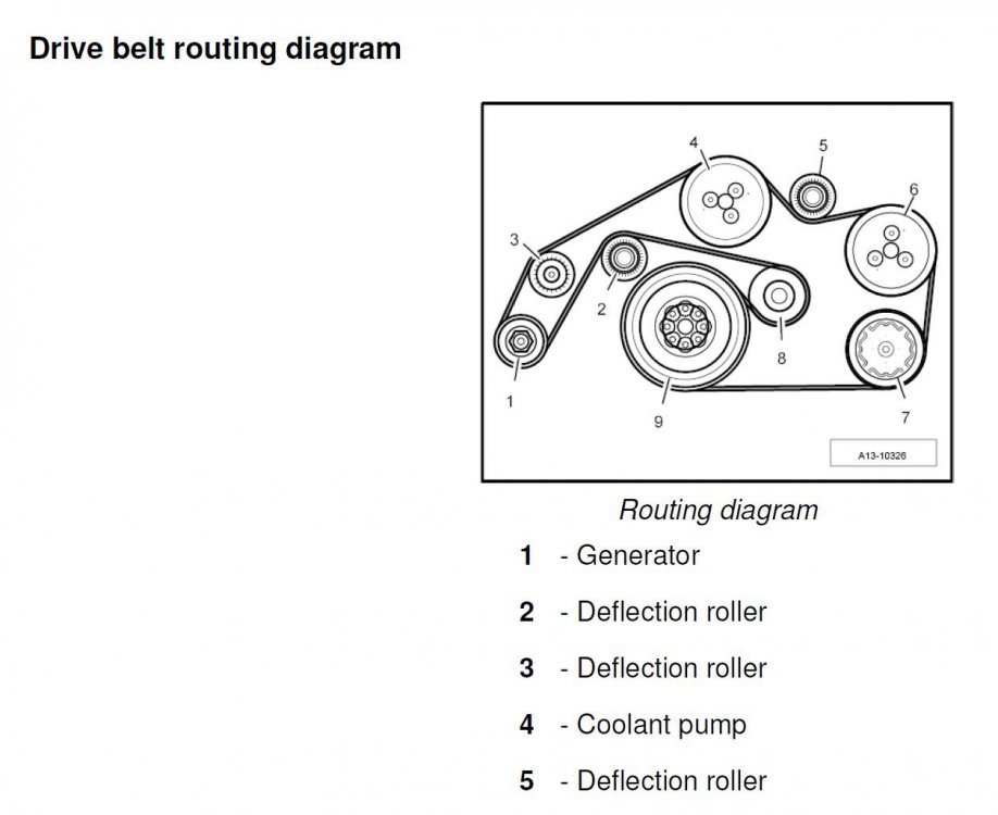

Removing and Installing the drive belt
1. Remove engine cover.
2. Remove front air guide hose.
Note: Only remove the drive belt when it is cold.
1. Mark the running direction -arrow- of the drive belt with chalk.

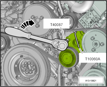

2. Relieve the tension on the drive belt by loosening the tensioner using a suitable tool.
To relieve tension on the drive belt, turn the tensioner clockwise.
3. Remove the drive belt and lock the tensioner using locking pin T10060 A.
Install in reverse order.
