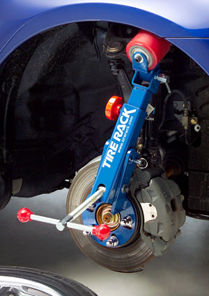

those f110s are super nice AND very light especially for being a 19" wheel. at less than 20lbs, lighter than some 18" wheels too. i couldn't swing the the price so i got the sportecs. if your car is not lowered or just slightly then it should be fine. if its lowered like mine then you will have to do some fender rolling. i may even go for a little more negative camber, it'll help out with the rubbing and help handling on the track too :D . i rolled the fender lips myself using the traditional fender rolling tool, a baseball bat. tire rack has a "proper" fender rolling tool for ~300 TIRE RACK FENDER LIP ROLLER
