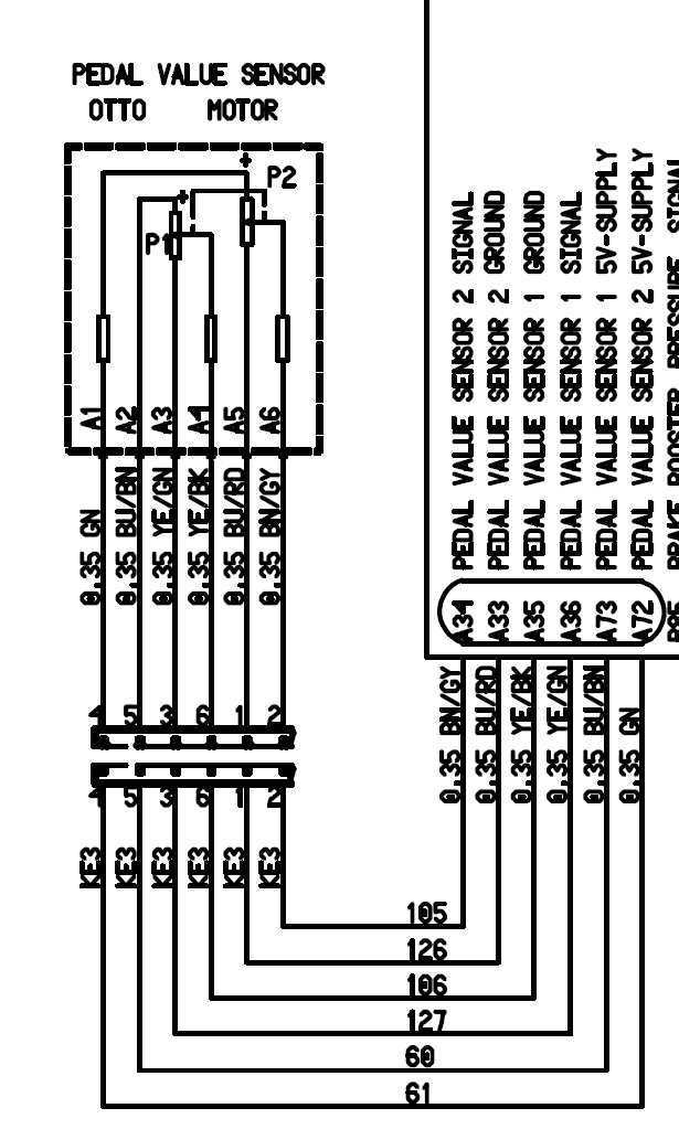

Hopeful request Cayenne accelerator pedal wiring Pinout
Good Morning Ladies and gents,
Please don't shoot me but i'm doing a dbw conversion on my 106 utilising the Porsche cayenne 955 accelerator pedal.
I can't find the pin out for the pedal anywhere  Pins 1>6  🤷‍♂️
Can anyone help please?
