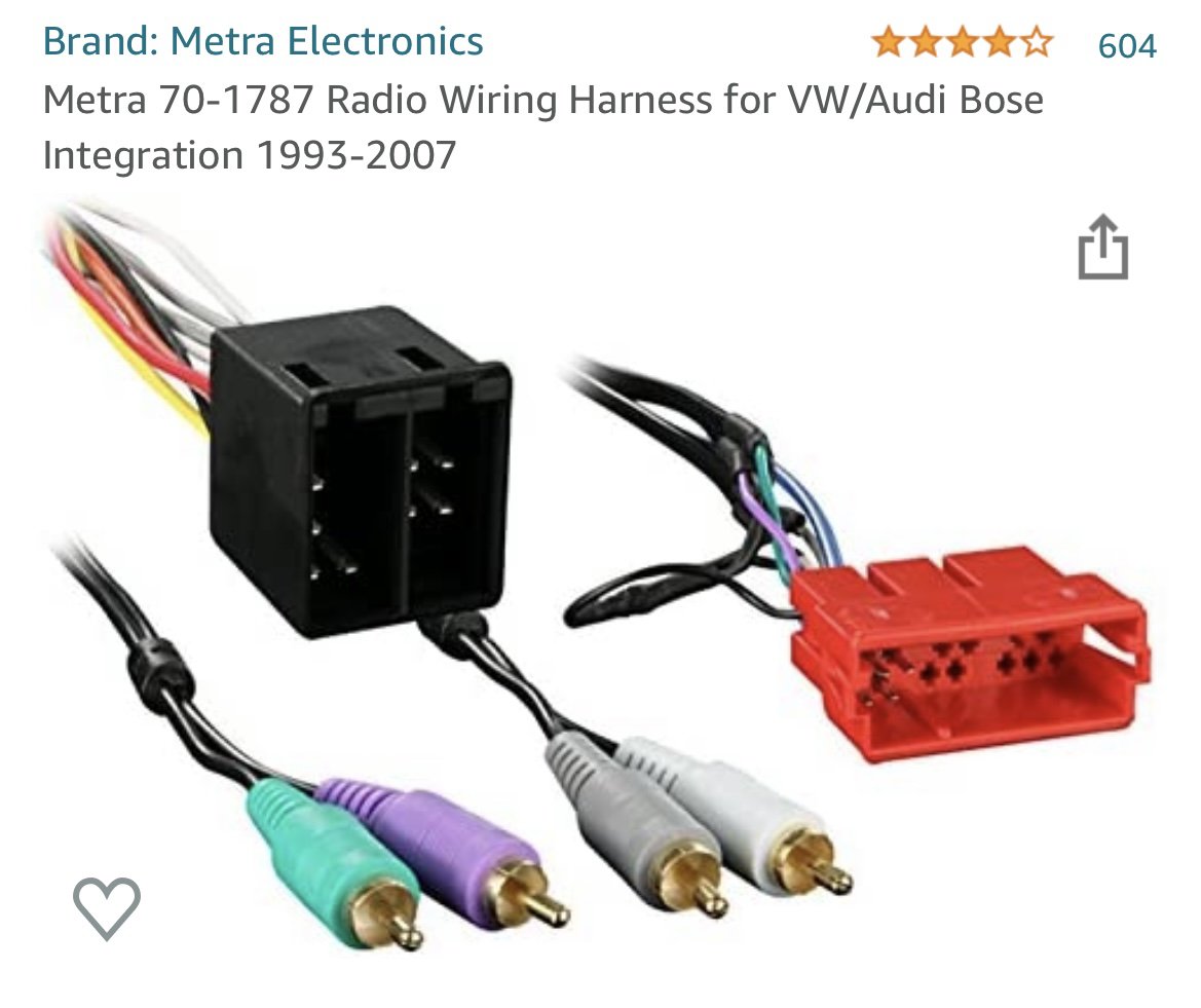

non bose and 98 porsche boxster. Did not use wire harness jus connected them (previous owner had already had cut the factory harness off. Do i need to the RCA plugs cause i did not see one when taking out the old head unit.
I do hear beep sounds from the head unit going through speakers wouldn't that mean that amp is already connected. Also what is the blue/red and blue/brown wires for.
