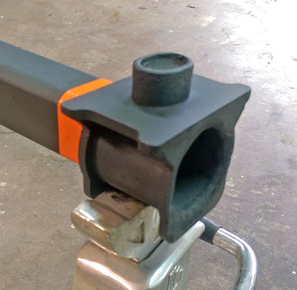

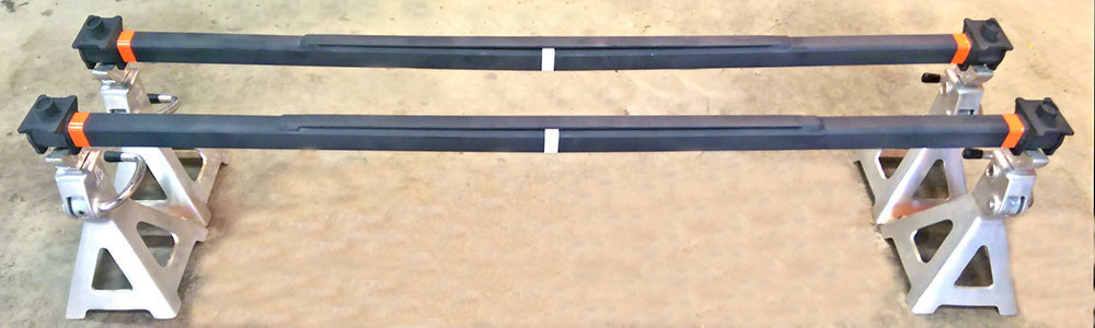

Going to be very tight at that height; while we normally work on a lift, if pressed to do it on jack stands, I would like to see 22-24 inches.  You are also going to need to support the engine while the gear box is out with either a support bar or screw type jack stand with a hockey puck on top to protect the engine case.  I have helped friends do this on stands using what are called Lift bars that lock into the cars lift points and 6 ton stands which can get the car safely up high:
Shown here under a 986 Boxster:
