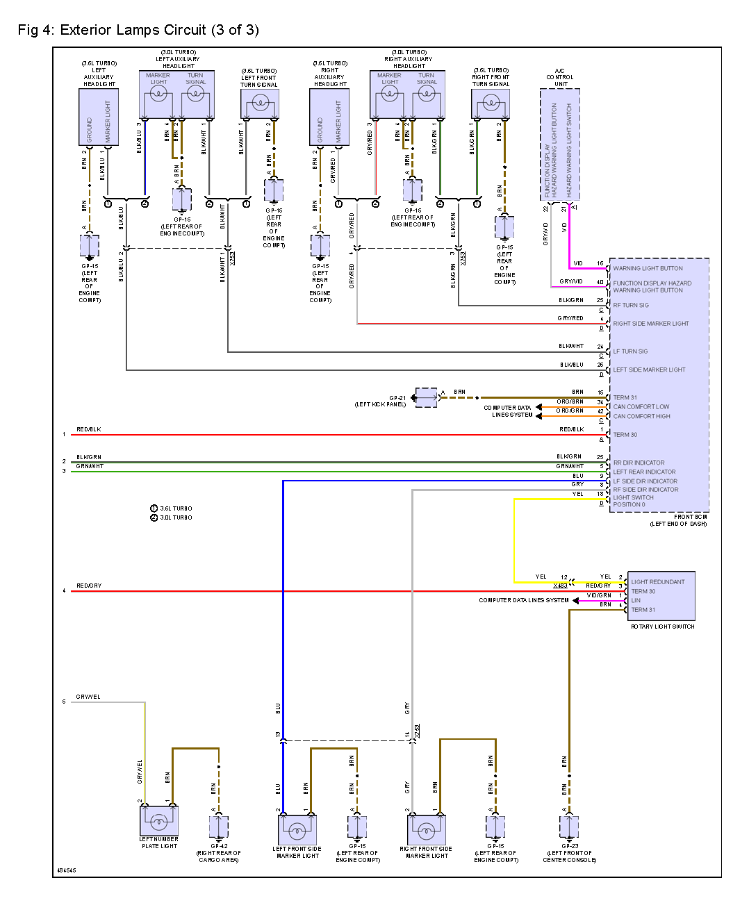

I think this is pretty basic stuff so re-programming the control unit for the headlights would be my first choice. Here is the basic wiring diagram and as you can see it is highly unlikely that both would fail at the same time.
Many thanks for your help Loren. Am I right in thinking that by "Re-programming" you mean it will need to be a Porsche main dealer? Or is this something I can achieve with the icarsoft POR scanner I have? 😃
