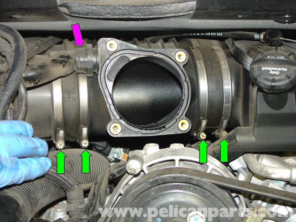

Replacing the ICV on my 99 and my question is this, can you replace it without removing the throttle body? The t30 socket I have will not clear the plastic pipe on the one bolt.  This plastic pipe “S” curves in front of the back bolt.

On 10/19/2022 at 11:41 AM, JFP in PA said:
Unless you have a tool that would get in there, you are better off removing the throttle body.

How do you remove the aos pipe?  The purple arrow from Pelican Parts tech.
