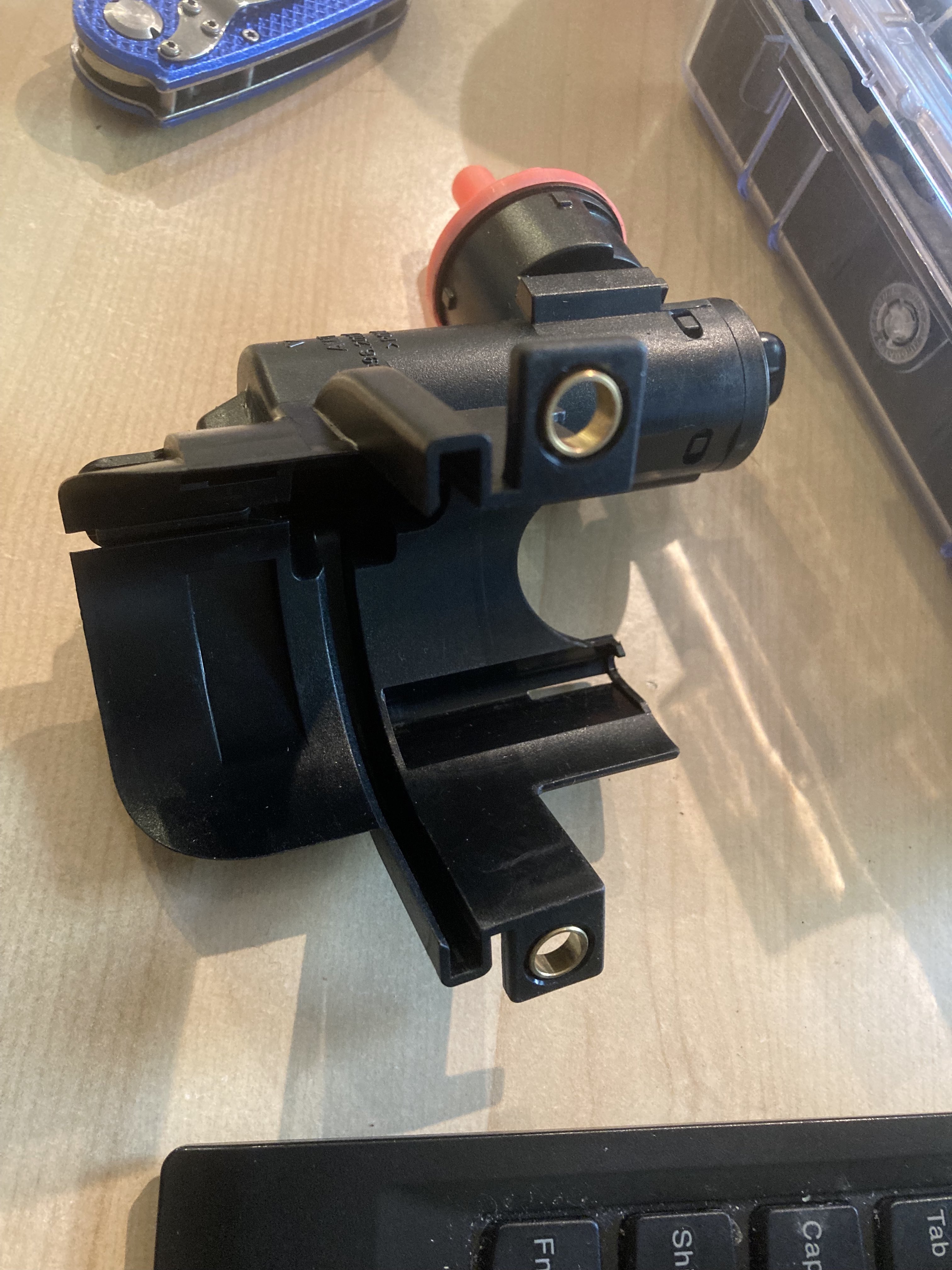

Thanks, seems like after I pulled out the vent valve the short went away, so that is where the issue is or in connectors leading to it..
How do I bench test the vent valve?
I do not see any obvious electrical leads to it.

I would like to bench test the tank bleeder valve from the filler neck that I took out and posted picture for.
You mentioned its an electric valve, so I would expect way to power it.
Are the leg screws way to power it?
The electric valves are not in that device, that device is the vacuum connection to the fuel tank and one way check valve for the EVAP system carbon canister.  The electric valves are at #1 and #6 in this diagram (#1 is under the intake manifold, 6 is at the EVAP canister).

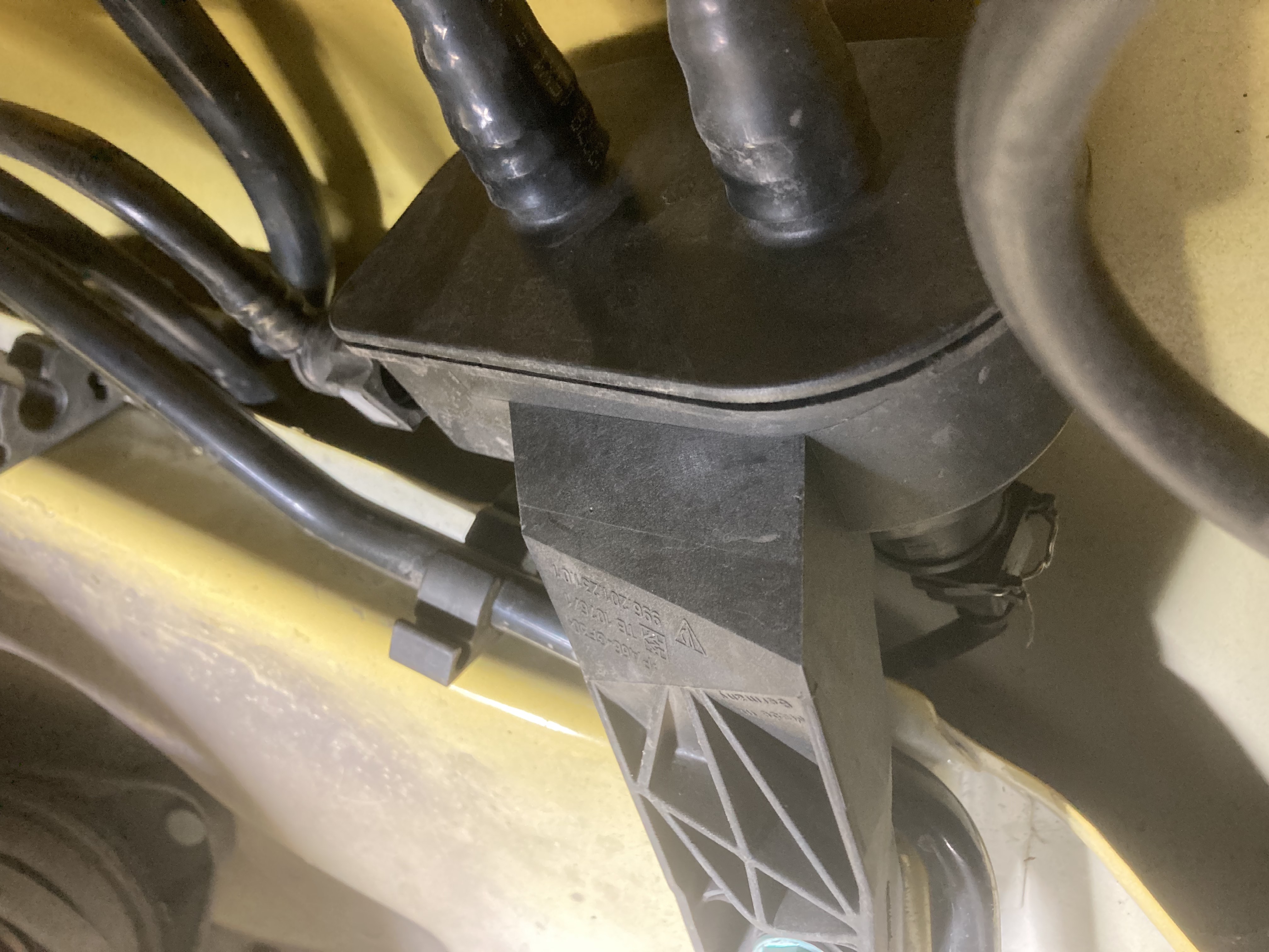

I think I am pulling wrong components out :).
I took out the charcoal canister and above it is a lock to the fuel door...
But upfront there next to lights there is a dual valve component with electric connections so that might be a suspect.
I think the other electrically operated valve that can get stuck is in the engine compartment.
