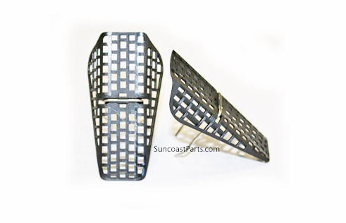

Porsche actually released a set of contour formed screens which do an excellent job of keeping the drains from getting clogged, but these still need to be cleaned periodically as they can get covered as well, but at least the drains remain clear:
You could probably also make something similar yourself.
Thank you for that, I'll take a look for prevention in the future.
Got a Part number on those screens? Or link to Suncoast part page?
Suffered from water intrusion last year shortly after acquiring my ‘03 C2…luckily not enough to damage my immobilizer. Front liner of rear wheel wells can be removed quite easily to access the drain outlets on either side. There’s a plastic pipe that connects the upper area to the drain pan(that theses screens would fit), they age and can crack or become disconnected. Mine were replaced with rubber hoses cut to length.
Off the top of my head, no, but any decent Porsche parts department should be able to help.
