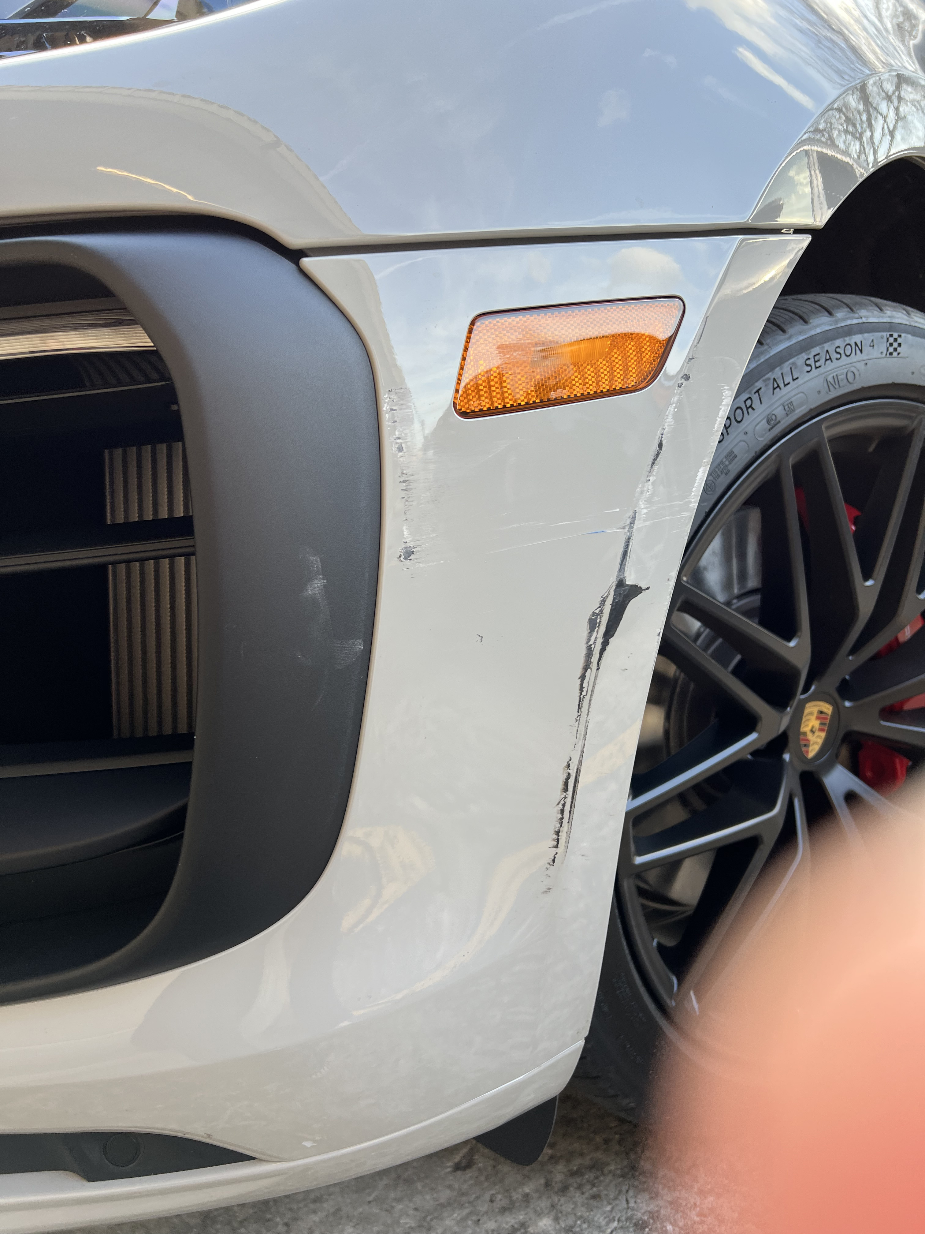

So 2 week old car got side swiped !!  Not bad as there are no dents, maybe a tiny ripple, but not worried about that.  Parking lot hit and run.  The bigger issue to me is whether or not to have the paint re-done professionally? Or at all?  Guessing it will eventually get worse - especially if using carwashes.
 The shops around here are awful and im not in the mood to have the body shop remove the fender and messing with the cameras / sensors.  And I really am not in the mood to have to potentially have them re-calibrated.  The shop said the paint job would take a week.
Thoughts?
Is it possible to find a good kit to attempt some touch up myself?  If so can anyone recommend a product you've used?

Will the paint peel - continue to get worse you think?
Dealer said no because  it’s a plastic bumper.

From the looks of it I don't think the paint will peel or worsen in the near future....... maybe if you don't get it fixed eventually it would but I don't think that's going to get materially worse on its own anytime soon.  Once they do the repair they can make that look like it never happened.

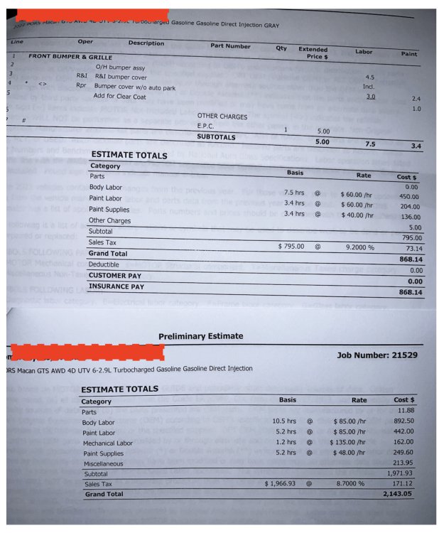

Going for my 3rd estimate today. 1st was about 900.00. 2nd about $2000.00 and neither include the 800-900$ camera recalibration. Have to take it back to the dealer for that.

That's a big difference between the first two estimates -- likely they are not apples to apples.  And, ya, it is normal for the collision department to send the car to the dealer for the recalibration.  That price sounds about right since dealer rates have gone up and it's likely a 2+ hour procedure to perform the calibration.
