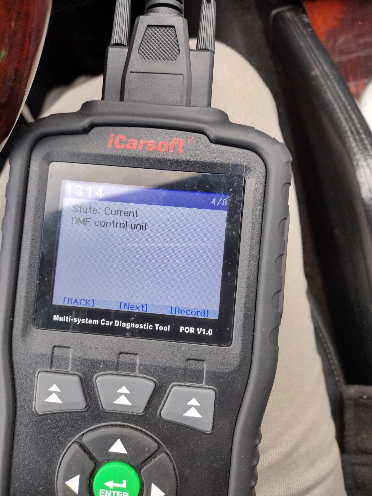

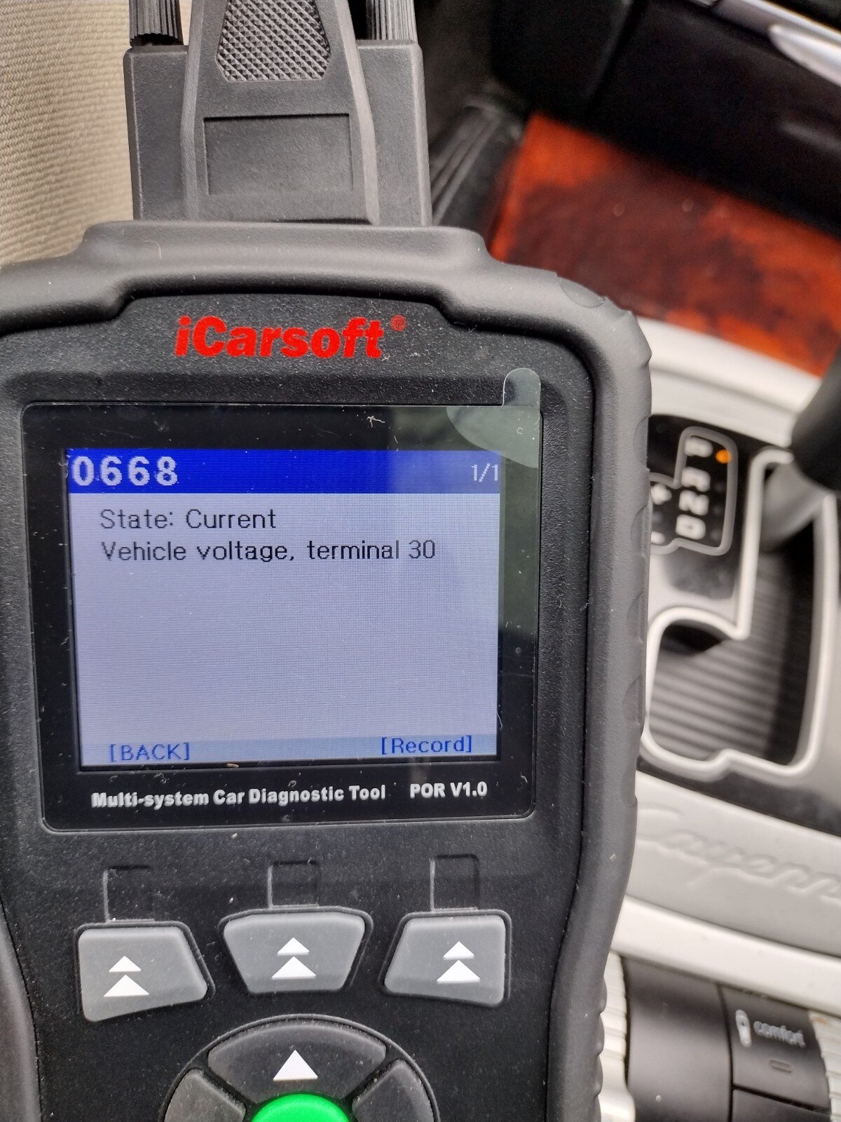

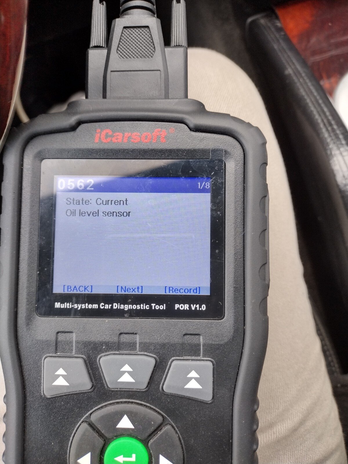

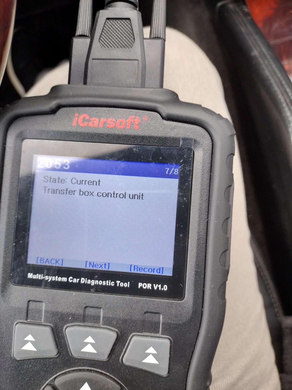

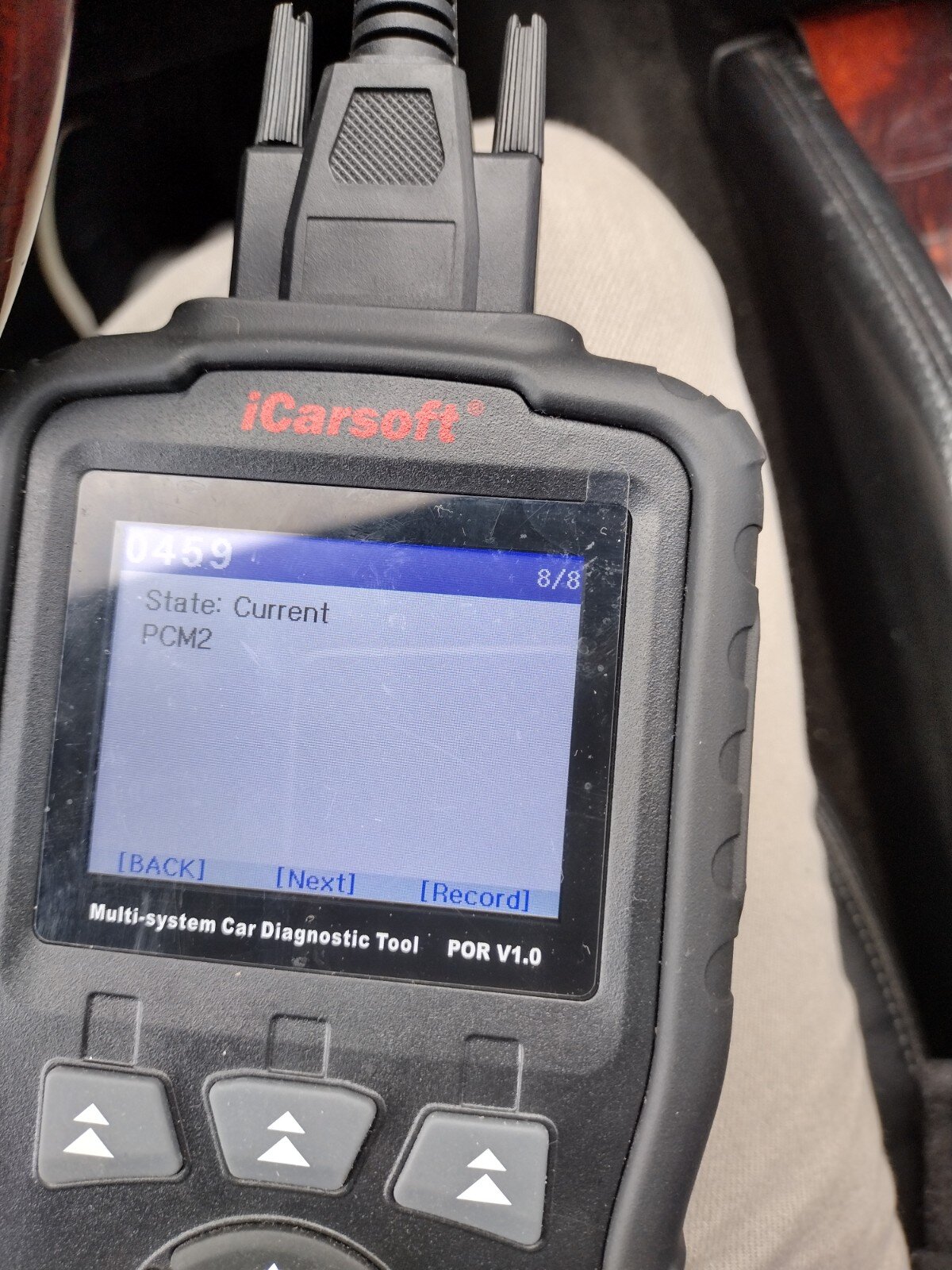

Thanks for responding. I went over to the Durametric site and checked out what their diagnostic tool can do. I own the icarsoft tool and am able to see the majority of the information that the Durametric tool offers. So I think I'm safe there. I'm attaching a link to a cloud folder with the pictures of the codes.
What I was able to do since my OP was verify that the starter is good and I got the scan tool to connect to every system except the DME which gives me a "no link...turn on your car idiot" message. I got a plethora of fun codes that points me in every direction and no direction at the same time. I'm starting to suspect that there's something going on with the ECU or a close relative. Here's my reasoning:
Intermittent Brake Switch Issues
Passenger High Beam Strobe Effect
No Communication with DME but can see every other system
Dash Digital Display Completely Died Yesterday
No Transmission Shift
Intermittent Dash Codes Flashing then Clearing itself
