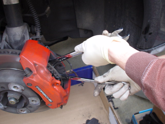

I'm about to embark on this same project myself, though I'm painting my calipers also. You will need rotors (I bought mine from paragon-products.com), pads (I presently have relatively new set of Pagid Blues that I bought from Paragon last year - they are good street/occassional track pads. If you don't track much or don't want to spend a lot money, stick with OEM pads), stainless brake lines (which is what I'm assuming you're talking about), and brake fluid (I recommend ATE Blue or Gold).
As for tools, you need a 19mm socket to get the lug bolts off, a hex socket to take the caliper bolts off (I don't know what size - either 8mm or 10mm, I think - I just have a set of hex sockets), a flare wrench to remove the brake line (sorry, I don't know what size), and a screwdriver to get the rotor screws off (you may need an impact screwdriver to get the screws off, though).
