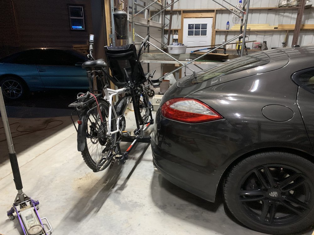

Hello, all!  I’m looking for a receiver hitch that I can use to fit a bike rack to my Panamera.  Does such a thing exist?

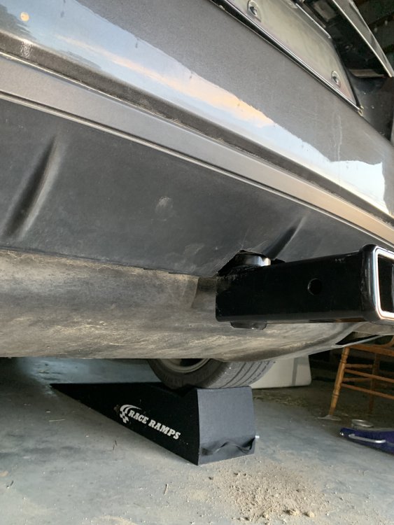

I did some poking around and took ballpark measurements off of a bunch of photographs, and I believe I have a solution.

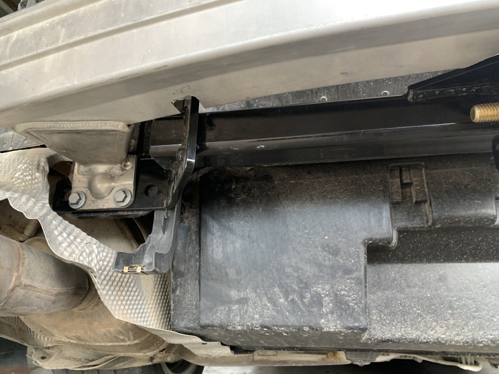

The stealth hitch for a Cayenne is a pretty close match to the 970. Since the stealth hitches for these applications replace the factory aluminum crash bar/reinforcement behind the number cover, you really don’t have to do much to adapt it.   Both the (now unobtanium) Panamera Stealth Hitch and the Cayenne model fit in the space under there just fine.
The bolt patterns are different, so I’ll have to drill some new holes in the hitch to match the 970 bumper mount, and there are a couple of other bits to deal with.  I’ll take some pictures as I go and post the process.

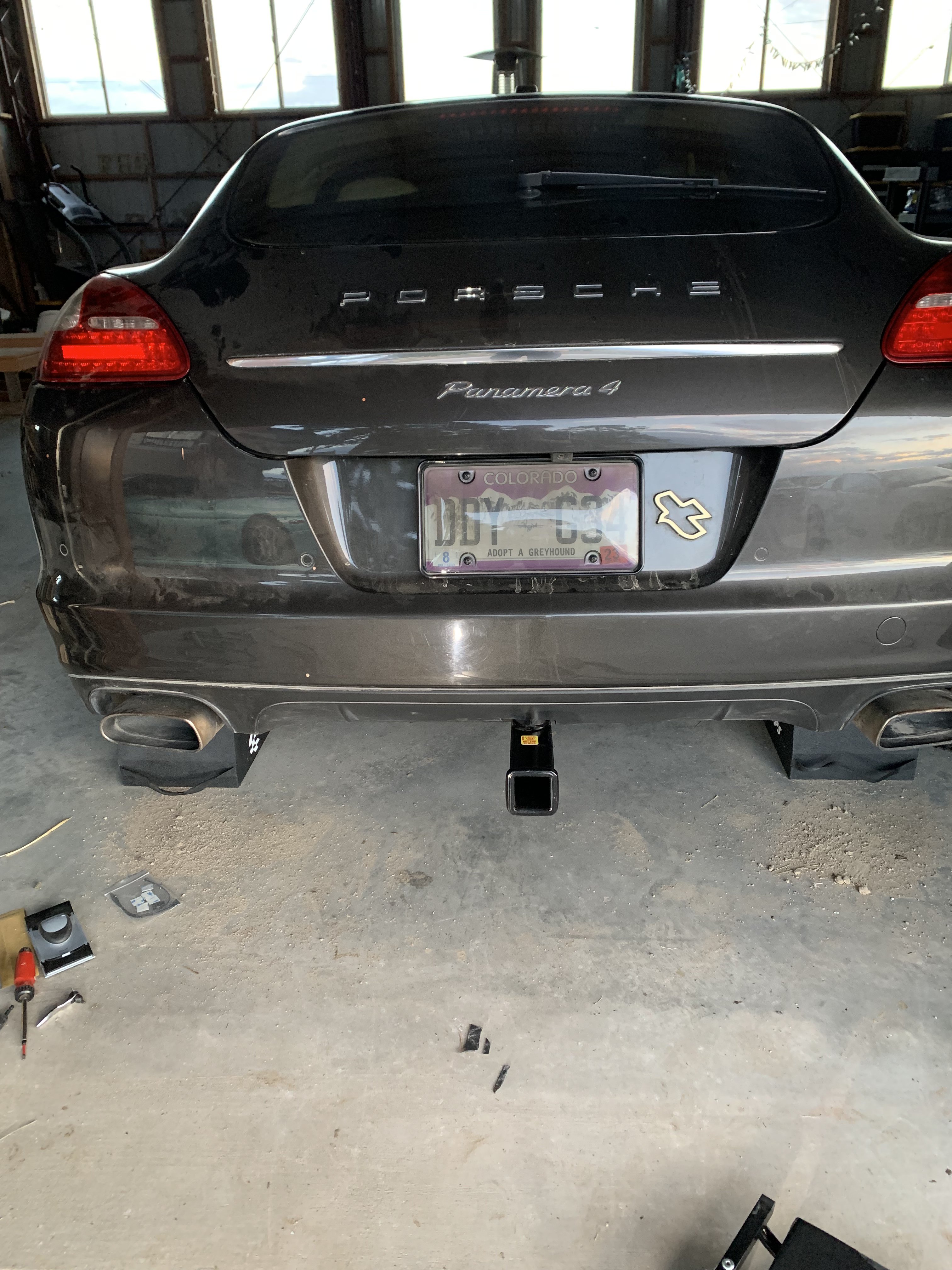

I dry fit everything tonight and I’m pretty pleased.

Success!  No pictures yet, I have one more hole to get right.   I was also able to trim the factory crash bar so that it fits over the top of the hitch.   This seems like a better solution than the “stock” process that removes it.   Which means I like the cayenne hitch better, actually!
