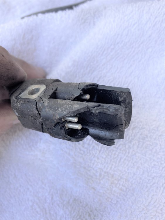

Problem was eventually traced to a faulty ABS pump/control unit. It did not hurt to replace all four deteriorated ABS harness connectors in each wheel well along with wheel speed sensors with cracked plug connectors. One of Porsche's worst material selections for such duty.
