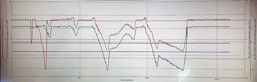

I am really at an impasse now, and as I saw some threads regarding the P0021 situation here I was hoping Loren or JFP or anyone might have some experience with something like this. I had a P0021 with the Signal Implausible clause (read from a PIWIS 2) after a 3-4 shift at WOT with a puff of black smoke out the back. Sure enough Bank 2 did not respond any more to throttle blips.

But after driving for a while I would see the offset between the 2 banks jump all of a sudden, and bank 2 occasionally not track bank 1
If I stop logging and reset the PIWIS they start moving in sync again! Which I thought might be the PIWIS, but the P0021 comes right back when this happens, so it seems real.

I feel pretty dumb, but I figured out the shift - I had no idea the PIWIS auto scaled each trace separately - duh. So they are in fact not shifted. But unfortunately I still get the P0021 coming right back. I think the problem is that although it tracks most of the time, there are times that Bank 2 just doesn't respond at all like Bank 1 - so in that graph like at the arrows.
DSC_0112s.thumb.jpg.d2b29f4a40a0719b8fe7e5167e0aa0ca.jpg.013ce45d6e45124e0404128714903efb.jpg
Looks like the variocam is sticking sometimes. Is there any oil "flush" that is safe and useful for this engine? I used SeaFoam on my Jeep, but not on the Mezger...thanks.
