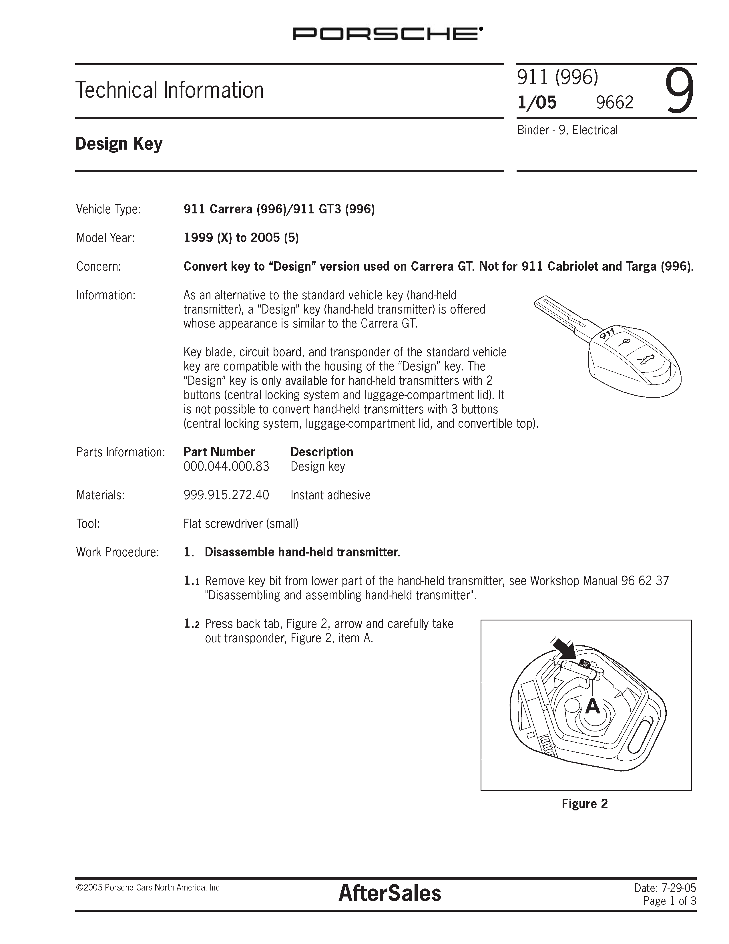

The simplest fix in to by a new key remote and transfer your physical key AND your transponder pill to the new remote.
Porsche sells a nice design key for that purpose and it requires no programming if you transfer the physical key and transponder.
