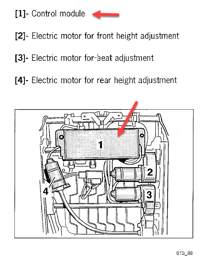

Just purchased my first 911 cabriolet, a 1999 996 with 58k miles. Need help diagnosing why my driver's seat - only clicks heard from the relays below the seat when I push the seat adjustment buttons in any direction, no movements at all. Good news as mirrors and passenger seat works fine. Heater works on both seats. Have pulled top of seat up and accessed all three motors, jumped to each with a feed from battery and all motors worked. Fuses are correct at 30A in E3 and E4. Have pulled connections and re-plugged each into the modules under seat, ground wire undone and redone - clean no rust. Help!
