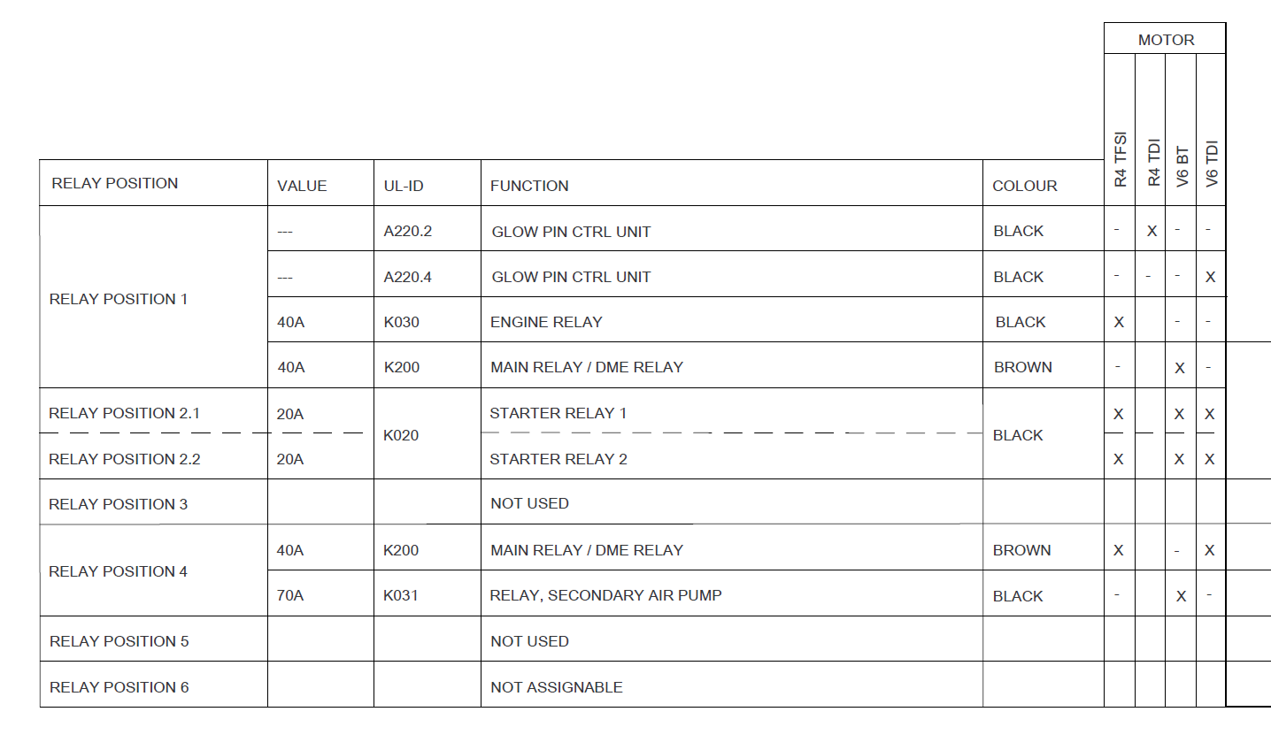

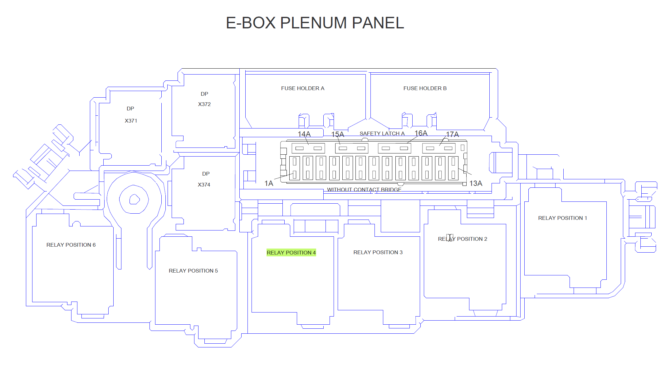

My wiring diagram shows a SAI relay in the plenum box, my parts catalog shows relays in the plenum box, but I can't find where the relay is, or exactly which is the SAI relay
I found some Audi Q5 info on the plenum box (which appears to be physically identical) which shows it as position 'C', which would be Relay position 3 on the Macan. Don't know how confident I am in that, though.
Does anyone happen to know either where the SAI relay is, or what its part number is?

Follow up in case someone has the same issue - changing the relay didn't do anything either. I did read where some owners got this code and it turned out to be the ground wire. Mine seemed fine, but I took it off, cleaned it up, and re-snugged it. After that, I was able to run the pump in test mode. So far, CEL has not come back!
