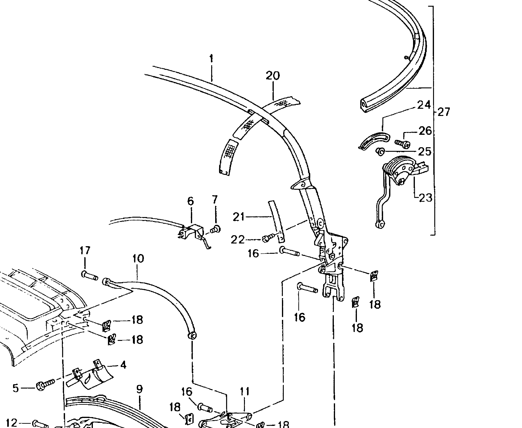

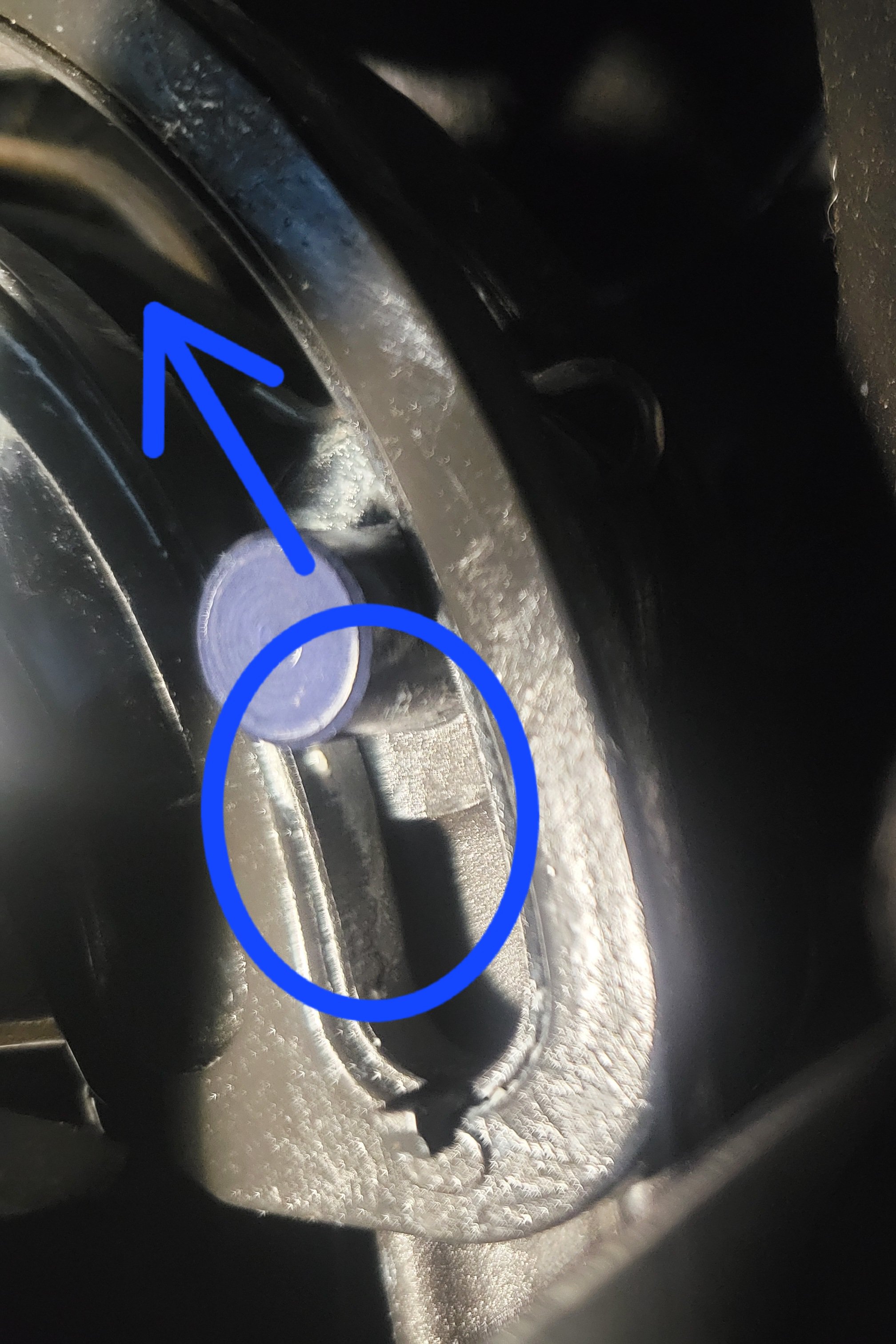

99 Boxster Base.  On both sides of the convertible framework there is a curved guide in which a pin rides. I have attached a photo from my car and what i think is the correct diagram with part numbers from the manual.  On my car the pin grinds on the lower surface of the guide for about an inch or so.  If you look carefully at the photo you may can see the paint rubbed off the guide just under the pin where I've circled things. It sounds horrible but doesn't seem to affect operation.  I think the pin is steel and the guide is Aluminum they are parts 24 and 25 on the diagram.
Maybe I've got the top adjusted wrong? - it opens and closes OK.

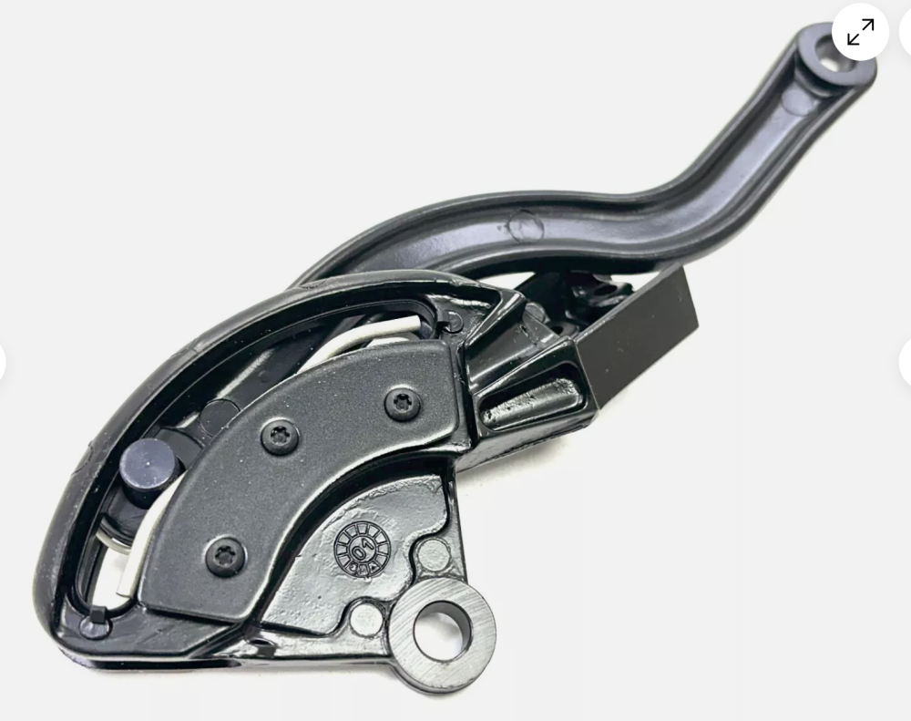

I can lube it but the pin is rubbing pretty hard on the guide so it pushes the lube right out.  Anyone ever replace those guides? Is that a thing one does?  Anyone ever filed down that guide right there to relieve the pressure from the pin?
