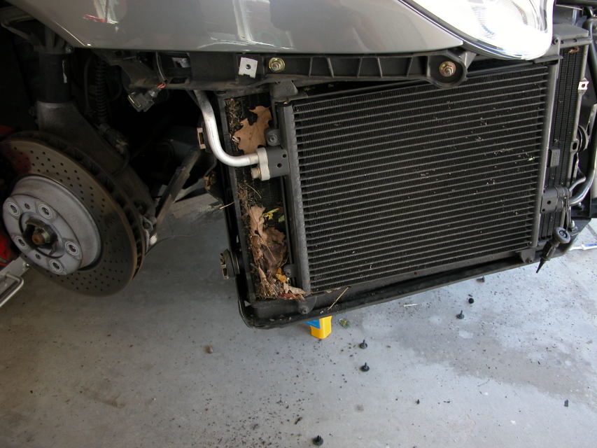

Removed my front bumper and cleaned
my rads....everybody should check theirs as this is what I found in mine. I only have 19K KM on my car.
Used my air compressor to blow out most of the stuff plus tooth brush, tooth picks to removed all the gravel which was stuck in the coil fins. Finally washed the whole thing out with a hose on high pressure....I think this will help keep her cooler don't ya think.
Many thanks to Loren for for the DIY..cheers Loren.
