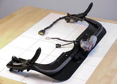

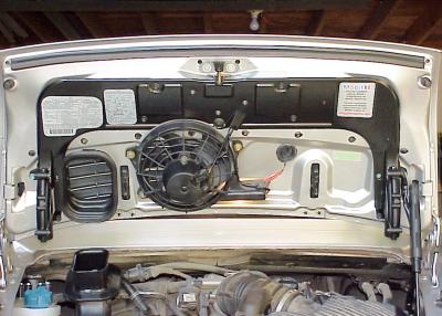

I haven't installed the PAG Carrera fixed spoiler, or an aftermarket spoiler on my '99 996 C2 Coupe, but I have removed and replaced the spoiler actuator assembly from my rear deck lid a couple of times since '98. Perhaps the pics I've attached may help you get oriented.
The spoiler actuator assy. in my pics was removed with the hinged spoiler temporarily left in the extended position, as you can see by the extended arms at each end of the removed actuator assy.
I removed the electric fan assy. only to allow better access to the area beneath the hinged spoiler, which I did not remove. I also didn't remove the "accordian" rubber trim piece at the trailing edge of the spoiler which you may have to remove.
If you have more specific questions, e-mail me. I have several other pics of the spoiler actuator assy., both assembled and disasembled.
