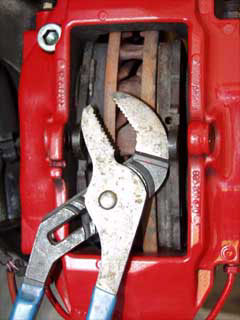

By the way, how low should a brake pad be to be low? Is there an eyeball measurement, etc. that can judge this?

To answer your question, take a small flash light and look at the pads inside the calipers. if you see that the thickness is at or about the hole in the pad where the electric wire is, you need to change pads. If you want, you can remove a wheel and remove the pads to really measure them.
