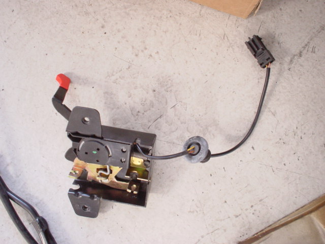

Here is the latch out of the car and you can see the 2 wires for the switch.

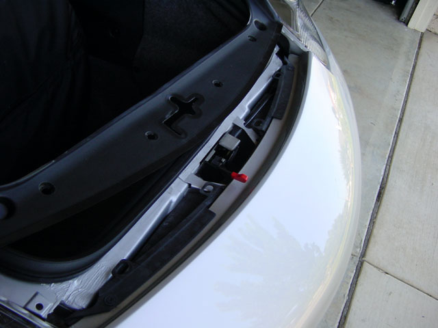

You need to remove the headlights and then the black plastic cover for the latch. The cover has these black round things you turn a few degrees with a screw driver so you can lift the cover off. Then you can see the latch.
