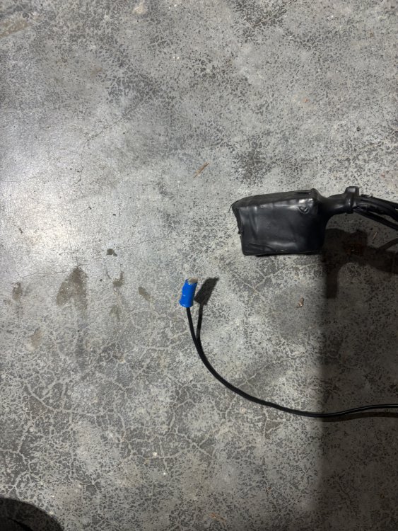

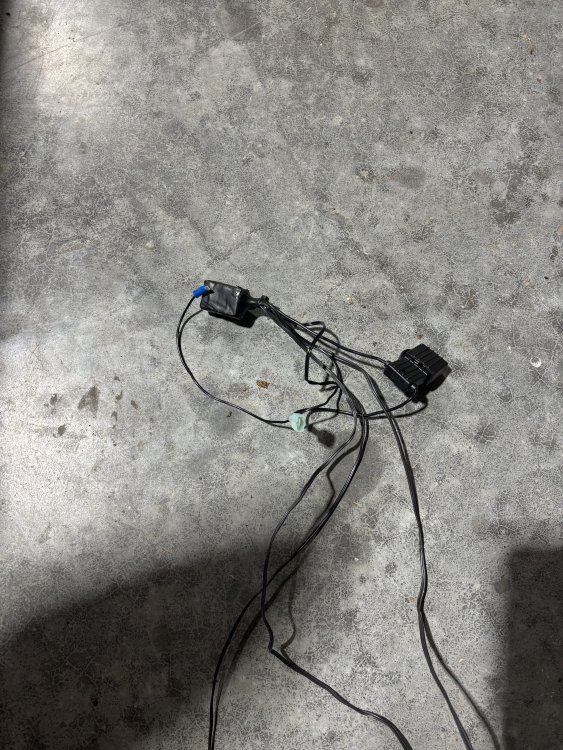

Sometimes things are just this dumb. Turns out someone had installed what looks like possibly some type of remote starter or something like that?  They tucked the wiring under the dash.  The secondary ground for that was tucked under the dash which caused the intermittent starting issues.  Last week, I found this wiring under the dash and removed it not thinking anything of it:
Notice the ring terminal that was mostly broken

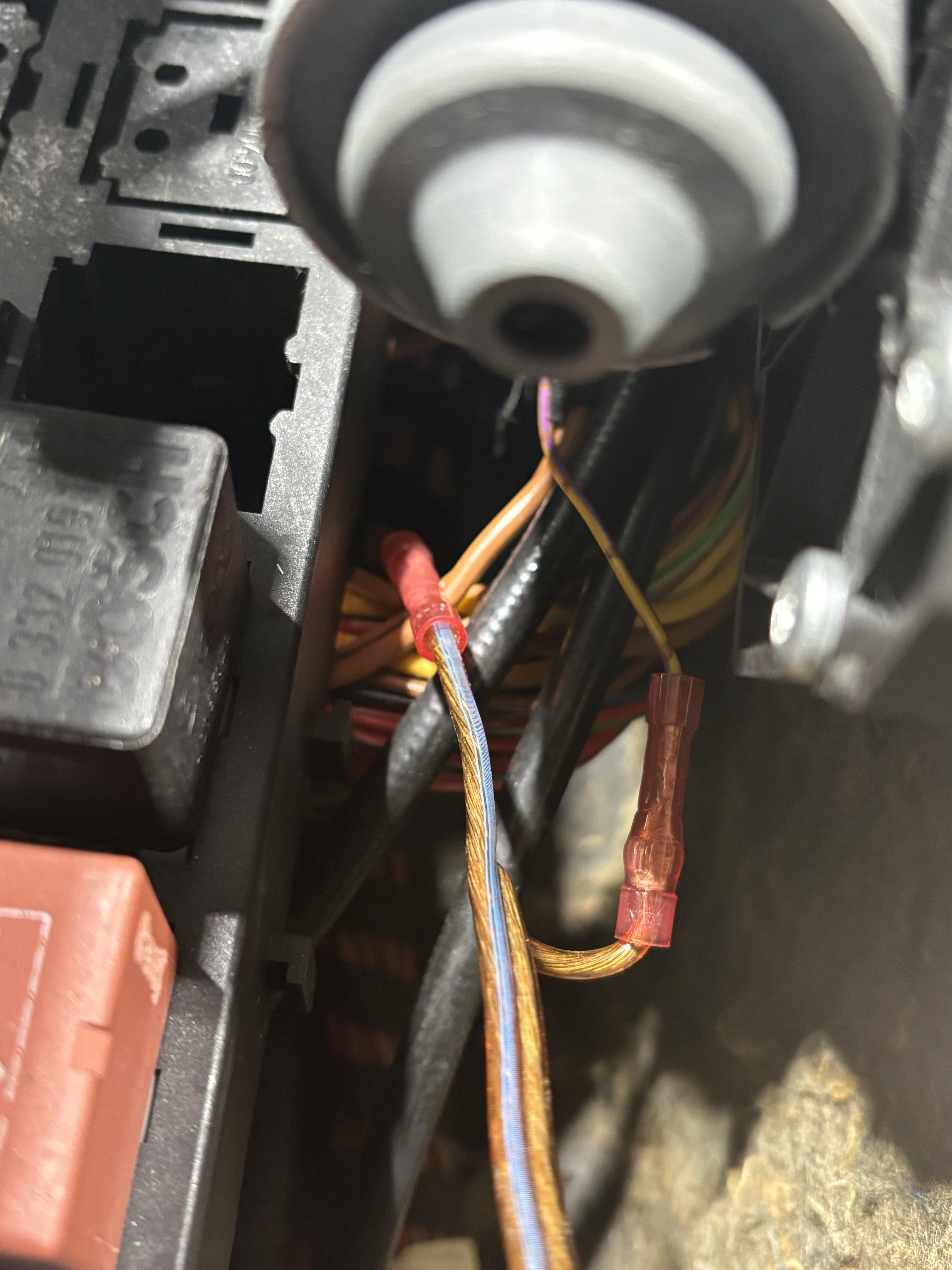

Last week I removed this wire almost completely.  It ran from the front of the car to the rear and was spliced in near the relay block.  Turns out it was connected to the ground wire for the starting circuit.  Yellow/purple wire with red stripes

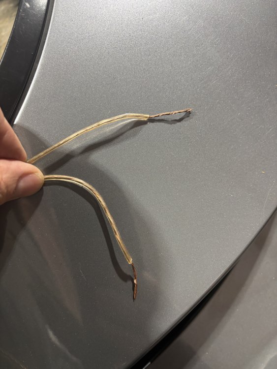

The genius who spliced into this wire used speaker wire.  I knew last week that something wasn’t right so I left a bunch of that speaker wire behind.
While going through the diagnostic at the advice of an independent tech, I started thinking that the jumbled up mess of black wiring likely was the culprit.
I confirmed that the relay circuit ground, 85, was the issue by using a multimeter.  I got zero volts on the 85/86 circuit with my wife turning the key.  Big thanks to the tech who guided me on that.  I now have a better understanding on relays.
Once I confirmed the 85/86 circuit was the issue, I figured the speaker wire was likely the ground in that jumbled wiring mess so I twisted the two speaker wire ends together and connected them to a ground
Car started after this point so I removed the speaker wire and butt connectors then reconnected the ground wire to its original form and put everything back together.  Getting my hands in there with barely any slack was a huge challenge, especially since I didn’t want to pull apart all of the cabrio guts.
