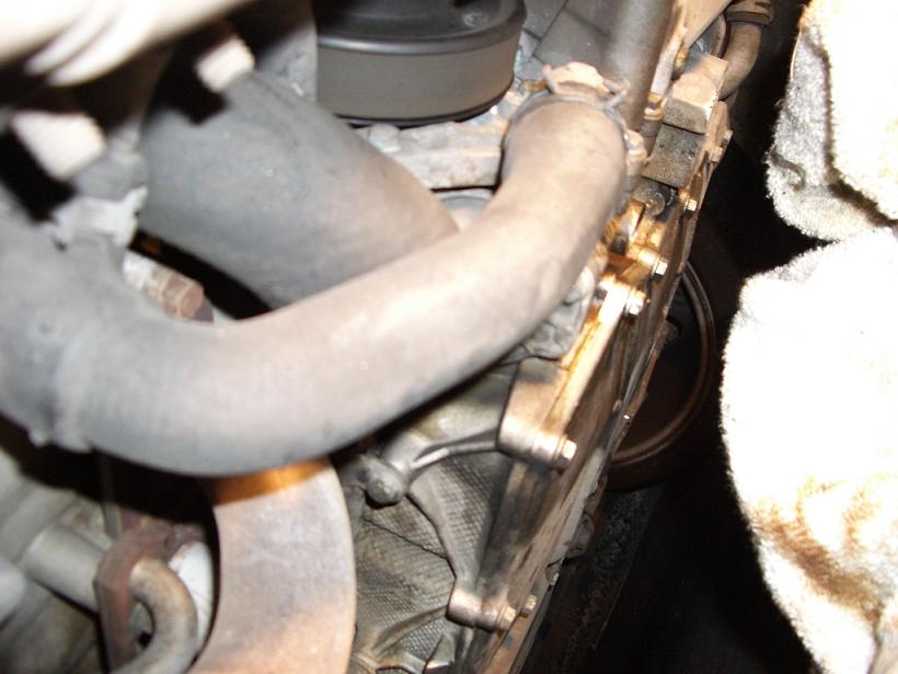

coolant light flashes after an 1 hour drive...
Checked the forum, found out coolant too low, went to check the actual coolant VERY VERY low.., almost lost half of my coolants.
Found drops of coolant under car... make story short .,. found out the leak near the clamp area of the main coolant hose see the actual leak in nake eye with a small crack in the hose........ as pointed in the photo

Are you sure it is the hose and not the tank (above the hose)?
Hose leaks are certainly possible but older tanks do crack and leak. If it is the hose you will also want to replace the spring clamp with screw-type hose clamps. If you want part numbers please provide you cars model year and transmission type (Tiptronics have some different hoses).

I am pretty sure its the hose , ... since the tank has been replaced less than 2 years ago by the dealer, I still have that invoice with me,. it was a $600 dollars damage.

Loren you are correct.,., the hose splite into a small hose... right where the photo disappear in to the engine bay.. and go stright up

Look under your car and follow the hose and look for two small connections on the hose. I think it is item 18 in the diagram above. If so you will need 4 new screw-type hose clamps.
