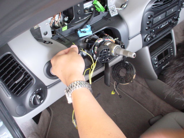

Wrong! All you need to do is make sure that the Order Type in DME is set to 986310 for a Boxster or 986320 for a Boxster S. Once that is set you exit the DME. Then go to Instrument Cluster, Modify Coding and change the setting.
Here are some pics of the 2nd part of the process: http://www.renntech.org/forums/index.php?s...indpost&p=34584

I just did it on my 2002S Dealer had no problem turning on the obc ! until you do the hack nothing will show! I used a footwell light switch and installed it where the seat heaters would be If I had them! Ray
