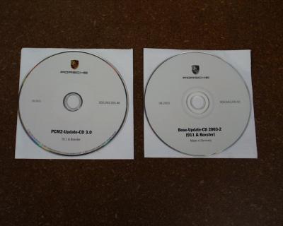

Hi Loren; I have received these two CD Rom Updates relating to the TSB. I will let you know what happens.post-6740-1137165956_thumb.jpg

Hi Loren; The Porsche-BOSE CD Rom software Update fixed the PCM2 code. Thanks for your help.
