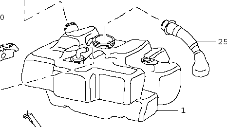

Thanks for the quick reply. that is interesting, although I would be curious to see what the shape of the gas tank was. If it is "saddlebag shaped", again it seems like it might change the dyanmics of the car as the critical mass of gasoline goes sloshing over the "hump" in the middle.
Does anyone know of any schematics/ photos of the gas tank?
