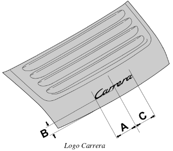

There is no placement guide in the 997 Service Manual or the Aerokit Install TSB. Here is what the service manual has for the (997) Carrera and Carrera S.
Carrera
1. Find the middle of the lid.
2. Position logo Carrera with the dimensions A and C Carrera logo dimension 129.6 mm+/−1 mm and B Carrera logo dimension 45 mm−1 mm and stick on lid.
Carrera S
2. Position logo Carrera with the dimensions A Carrera S logo dimension 175.6 mm+/−1 mm and B Carrera S logo distance 45 mm−1 mm and stick on lid.
3. Position logo S with the dimensions C Carrera S logo dimension 175.6 mm+/−1 mm and D Carrera S logo distance 39 mm+/−1 mm and stick on rear lid.
