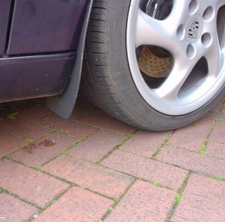

I'm not sure what you mean by 'gravel guards' as it isn't a term we use in the UK. We have things we call 'mud flaps' which I believe are called 'spashguards' in the US. Anyway, these are what I have fitted to my car:
I think they are quite unobtrusive on mine, but would be more obvious on a light colour car.
They came from Mid-America Motor Works (www.mamotorworks.com).

Hi Richard:
You're right, those are known as mud flaps, or splash guards. And I would agree, they don't look terribly intrusive. But, what I'm referring to by gravel guards is a custom cut set of clear something or other (vinyl, plastic, etc.) that is applied to the front of the car on the bumper cover, about the first third of the hood, behind the wheel well and around the headlights. They are designed to stop road rocks, etc from damaging the finish, like a bra, but are nearly invisible. My car had an aftermarket set, but I don't know where they came from. The OEM kit is $1200, which I think is ludicrous. I will check with Mid America to see if they have what I need, but still welcome thoughts and suggestions on the issue. Thanks for your input, Richard.
