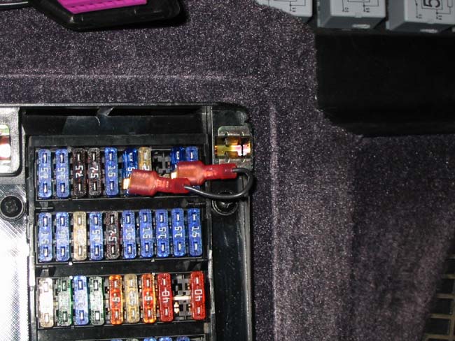

It would be quite difficult to hide the V-1 transformer thingy anywhere near there. Is there any problem tapping off the fuse panel? There are unused slots that have 12v power. Would this cause CAN bus problems?

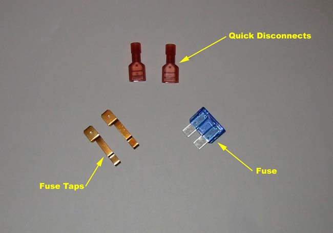

Yes, you could come off the fuse panel. Radio Shack has jumper/tap that makes it very easy (Radio Shack #270-1204). This is a jumper but you get the idea...
(Images courtesy of Yoseif)

I installed my V1 radar detector just to the right of the rear view mirror, modifing the winshield mount by taking off the suction cups and replacing them with double-sided take. It is now firmly positioned in the right place (rear horn can see out the rear window) and quite out of the way. You can easily find switched 12v at the fuse panel (either an unused fuse holder (V1 power wire is already fused) and just stick in the wire where one end of the fuse would go, or stick it in beside a used switched fuse slot). There is a nice slot right at the top of the windshield where hide the wire (I used a few pieces of black foam rubber after the wire was placed there to make sure it stayed in place (everything is hidden from view), then run the power wire down the same slot on the left, tuck in out of sight and down to the fuse panel. It is easy and totally invisible with nothing to modify.
