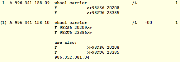

wheel carrier
For example...
If your VIN starts with a number lower than 98XS6 20208 then you would use the first part (996.341.158.09) if your VIN 98XS6 20209 or higher then you use the second part number (996.341.158.10) and the additional part it suggests. If you call or email Sunset Imports (Porsche Parts at Dealer Cost) they can explain t to you in more detail.
You also know you will need some special tools to change the wheel carrier?
