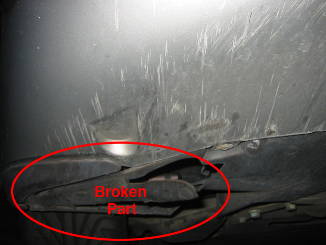

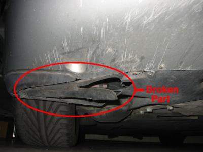

I notice this part under the bumper, something was broke off. But can't tell what it is.
I looked at PET CD and nothing come close to what it looks like cover or something like air duck?
Any idea? I would like to repair this ASAP before long trip to San Francisco and Portland next week.

Its an air duct for the brakes -- cheap at the dealer - maybe 3 day delivery
Ed (Arizona)
Part number ? If you know, I really appreciate...
Waiting to call jeff once I know what the part number is.
996 505 525 00 Left
996 505 526 00 Right
...good luck

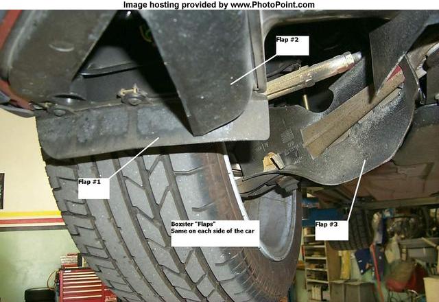

Well.. turns out it wasn't the brake air duct. it's right next to it...
Toolpants !! HELP!
Sorry, didn't look at your photo close enough...
I looked at your photo a little closer and then looked under our 02S. This part could be attached to the whole front underbody lining cover -- your broken part on mine is on the front underbody lining cover: PET Illustration 801-70 #1 Part number 996 504 527 02 The PET drawing doesn't look the same as the part (don't know why)
...Jeff probably knows why
From seeing the scrapes under your car IMHO I wouldn't fix this broken plastic untill you get a front end accident and then do the whole thing -- Ask, Jeff -- sooner or later someone will hit you backing up because they "didn't see you".
Good luck,
Ed
I just replaced Flap #1 and Flap #2 in Tool Pants picture on both sides of my 996 . Here are the part numbers for left and right. I thought the 986 was the same up front for most parts but it does not look like your photo.
1 996 504 604 00
1 996 504 603 00
1 996 504 504 00
1 996 504 503 00
1 999 073 061 02 screw
ordered them from Sunset arrived 5 days later.

Having replaced my wheel arch liner on the offside I realised when looking at the old one that I had taken off that I am missing the parts on both sides labelled flap 1 in the picture above, I am going to order these tomorrow and they hopefully get rid of the wandering feeling at high speeds. My question is, are there any other sort of flaps on the car than runs across the middle, it looks as though there are fixing points for something to fit onto. I know that the MR2 roadster has the same sort of flaps in front of the wheels but also has an additional one across the middle as well. I appreciate there is a difference between the cars but the principle would be the same.

there are no other flaps in the middle of the car but if you could post a picture of the attaching points you reference then maybe somebody could help with the answer. The flaps in the picture have nothing to do with the aerodynamic stability of the car at high speed. I would suspect that your alignment probably has more to do with your wandering issue. As a point, in the future you need to post your model year, Model, body type, and left or right hand drive when asking a question. That helps get to the point quickly.

I read on another forum, and there is a picture with an air tunnel, and it shows that these flaps do make a difference to the air flow around the wheels, why put them there otherwise? Mine has been recently aligned and is spot on.
Got my bits this morning and will be crawling around underneath the car later! Thanks for the reply

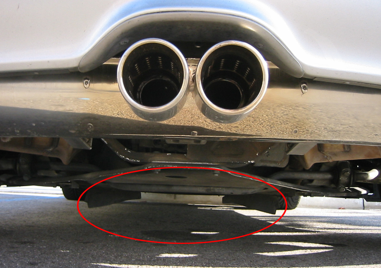

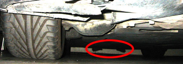

I think Liz is refering middle/back flap where rear wheel shaft is.
Here are some photos I took from last week.
Edited by vfxbox
Hadn't seen those one vfxbox, I did mean at the front where the bumber meets the underpart of the body, but I was mistaken as there are no fittings on there. I had only look briefly last time, was right underneath the car today so had a good look.
