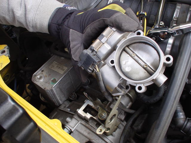

The throttle body does not have to be removed - but it is easier to clean with it off the car (IMHO). It can be easily taken off - four bolts and the electrical connector as I recall.
Here is one I removed at a work on cars day last year (2000 Boxster). Tariq had the same problem with an occasional erratic idle. Cleaning and reinstalling did the trick.
(my hand - Tool Pants pic)
The car does not need to be running when cleaning since you will need to open the butterfly with your fingers to clean around and behind it.
