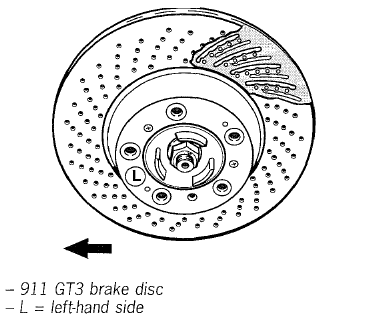

Pretty much the same for a GT3 -- be careful the rotors are directional.

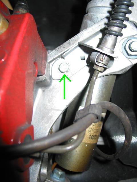

2. Front rotors: after removing the 2 caliper bolts, will the caliper have enough room to swing off the rotor without removing anything else (such as brake lines)? It appears that the brake lines are rather fixed and that I would need to remove a 10 mm hex bolt (see green arrow) to be able to freely remove the caliper off of the rotor.

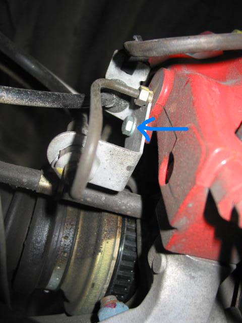

4. Rear rotors: After removing the 2 caliper bolts, should I be able to remove the caliper off the rotor without disconnecting anything else? Once again, it appears that I may need to remove a 10 mm hex bolt (see blue arrow) to be able to freely remove the caliper.

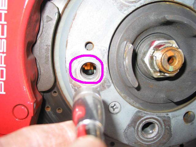

5. I'm still not clear on how to adjust the parking brake at the drum. I look through the threaded bolt hole and see 2 little brass looking pads/discs. How does this adjustment work at the rotor?

2. Yes, you can remove the bracket. I usually just hang the caliper off the spring with a wire or twine so there is no pressure on the brake lines/fittings.

4. If that is attached to the caliper wouldn't come off with the caliper?

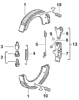

5. You take regular screw driver and rotate the wheel - like you are prying it in the direction it will rotate. One direction tightens the parking brake shoes and the other way loosens them. Item 2 in the pic is the shoe adjustor. You are turning it to force the screw (lower part of 2) and the bushing (3) either to push the shoes out or bring them in.

4. Regarding the rear caliper, yes, the bracket will come off with the caliper, however, the bracket appears to house ABS (?) lines in addition to brake pad sensor lines and the ABS lines are fixed to the bracket with no slack. It looks like I'll have to remove the bracket to freely remove the rear caliper. They must be ABS lines... I can't think of anything else they would be.
5. I see. I was looking at the wrong part of the drum assembly. I was looking at part "7" rather than part "2" in your diagram.
6. Good. It shouldn't be a problem then once I learn how to adjust the rear drum brake.
