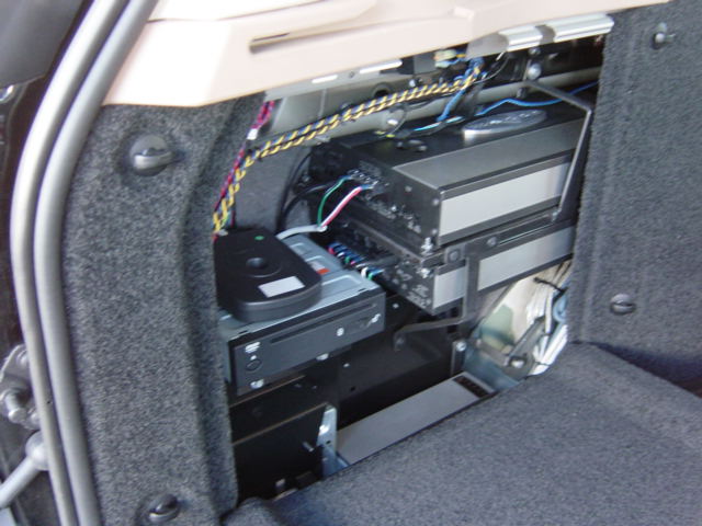

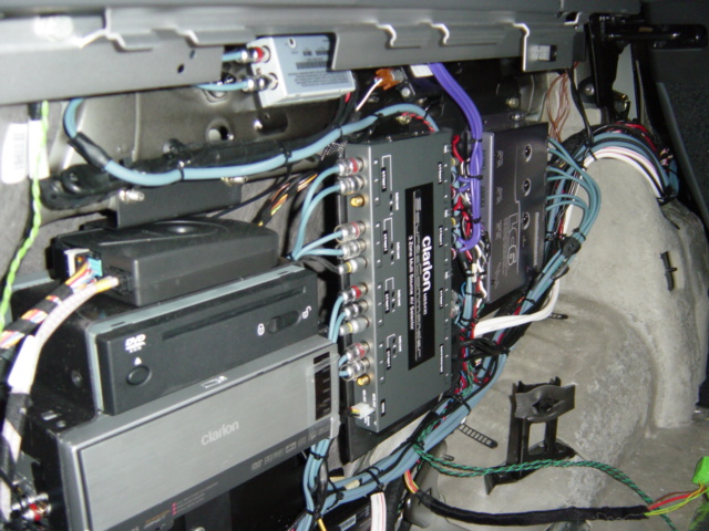

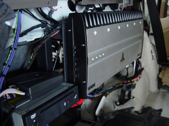

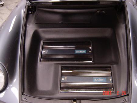

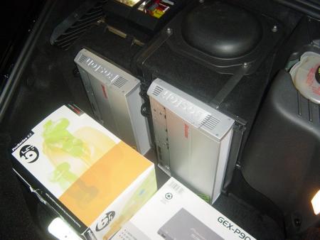

Make sure you go to a shop that will mount the amp and box the right way. Alot of places will screw the amp down to the car. The shops that do it the right way will make brackets out of steel that will bolt of your cars factory bolt locations and the amp will bolt to the bracket. here are a few photos to give you an idea what I am talking about. Feel free to ask me any other audio questions. I was in the field for over 7 years installing and running shops
NOTE: the last 2 shots are a little extreme when using the whole trunk for audio.
I did include one 996 picture holding 2 amplifiers

Thanks Bruce. I'll be auditioning all the speakers before I buy. I see what you mean about the brackets too. Thanks again.
