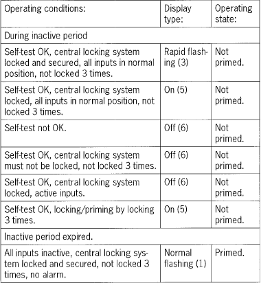

Thanks Loren, I'd seen that post regarding the battery trick when searching through the forums...but the fact that the light on the dash is never on confuses me. Would flipping the battery cure that as well?

Flipping the battery causes an alarm transponder reset. It should clear up any communication issues between the key transponder and the alarm controller - unless the key fob is bad. Do you have the other key and does it do the same?
Alarm readiness (light) states
