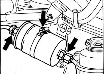

Jeff,
I just posted Joel's comment...
Here is the inforamtion on changing the fuel filter:
1. Unhook clamps of air cleaner cover. Take out housing cover and filter element.
2. Separate air cleaner housing from intake air rail and unhook from air flow sensor. Lift up air cleaner housing and take out housing. Be careful no to lose the a-ring in the air cleaner housing / air flow sensor.
3. Undo fuel lines, using a second wrench to lock. Drain remaining fuel into a suitable container.
4. Undo clamp and remove fuel filter.
5. Fit new filter. Observe direction of flow = direction of arrow.
6. Start engine and check fuel lines and fuel filter for leaks.
Check fuel and injection lines for leaks and tight fit!
