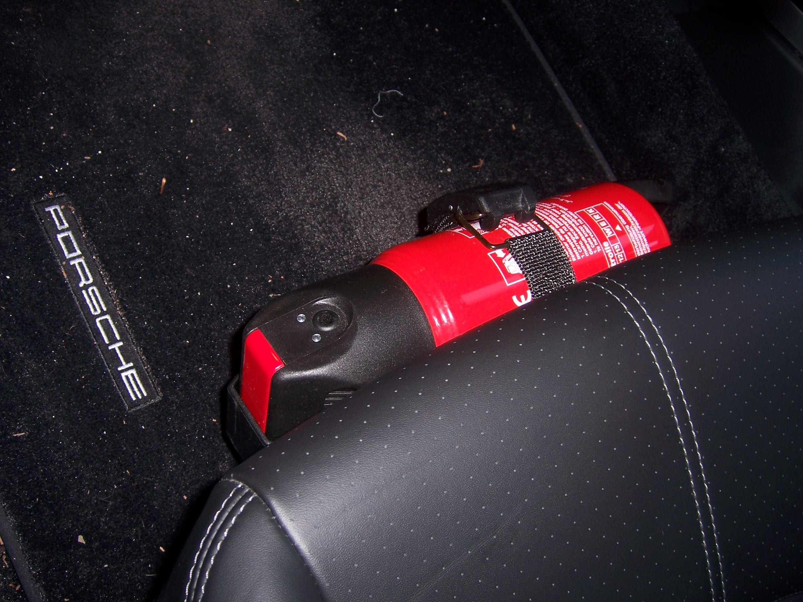

Hi,
Here is a picture of a factory installed fire
extinguisher in a 997 S. It looks
different then your halon picture.
Paul
Paul,
Do you know where to buy the factory fire extinguisher? My Porsche Dealer, Wilmington, DE, tell me these Porsche factory extingusihers are very very hard to find in the USA.
Fred

I bought the original 996 fire extinguisher brakcet and then bought the Gloria 1Kg F1 fire extinguisher which can be foudn and was the standard item for Porsche , looks good , the original fire extinguisher bracket for the 996 is all red and goes in teh drivers seat, a bit in the way but not a big deal. The Gloria F1 fire extinguisher comes with its own simple bracket also
