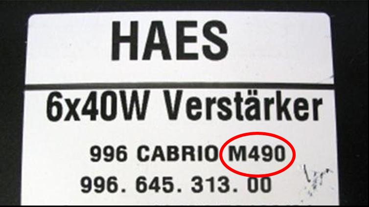

Yes, I got mine thru Ebay. They show up occasionally, but not all the time. Just make sure you get the one that matches your system - M490 or M680 (has DSP). You can add a M680 to a 490 system, but only if you get the control panel and are interested in modifying your center consol to fit it. The other option would be to just add a 2ch amp piggy-back to your stock amp to drive just the rears. (PNP has a kit on Ebay often, but it's another $200 which I think is high and the power rating is so much higher than stock, most of your sound/power will come from the rear then). The other place I think you might be able to find one is a local swap.
I'd check w/ a dealer just to find out the cost of a new 6x40 amp so you can bid intelligently on the used one. Personally, I wouldn't pay over $100 but that's just me.
Do you have separate sound system control below your radio in the center? If so, you've probably got the 680 DSP. If not, then as long as you have door speakers, you'll have the M490 pkg. You can check the options listed on the sticker in the front trunk, or look at the sticker on the amp in the front trunk. The front trunk sticker will just list option 490 or option 680. If you check out the amp, your sticker will look like the one below except your part # will start w/ 986.... and will either have M490 or 680 where I have circled in red:
I thought that the M490 option added the 6 channel amp. When I bought my PNP rear speaker kit, Harvey told me that "...the '03-'04 M490 MOST bus cars do not need the amp kit. The cars have an amplifier capable of powering the rear speakers so you wouldn't need the additional amp. The rear speakers will plug into the existing amp with the extra harness furnished [in his kit] for the 03 and 04model years."

On the '03-'04, the M490 option does include a 6x amp. '02 and prior only include a 4x amp. Mine is a '99 and I originally only had a 4x40 as part of my M490. As I recall, I think the original question was regarding an '02 which would be the same.
