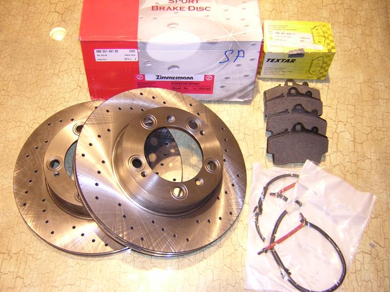

Zimmermann does sell cross-drilled rotors for the base Boxster. Easy to find on ebay, and the picture below is from ebay for the front base Box.
